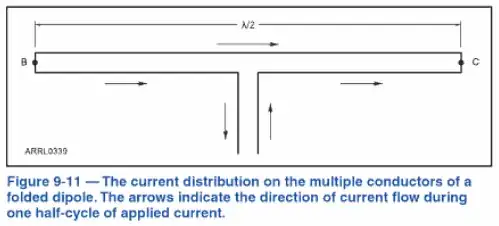

Perhaps an illustration will help (ARRL Extra Class License Manual):
Folded Dipole Current Flow
Remember, this is AC current. At points B and C (the ends of a simple dipole) it drops to zero. Since a folded dipole is like extending a dipole by a 1/4λ at each end, we will observe the current reversing at B & C as we start a new cycle.

  • Maybe you can elaborate on "As a result the current in the new section flows in the same direction as those in the original dipole." It's somewhat counter-intuitive to imagine that an antenna that makes a loop results in in-phase currents. – Phil Frost - W8II Dec 02 '13 at 21:39
  • I've added a picture and some more text explaining the current flow better (I hope). – WPrecht Dec 02 '13 at 23:58
  • Better, though it's still a big mental jump to see how the current "turns around" at points B and C. The natural thing to do with this image is start at one half of the feedline and follow the arrows. They all point in the same direction, except the one at the top. This is something that's bothered me a long time, which I always thought unnecessarily difficult to learn -- I'm certain the solution is a picture, just not sure what. Animated, maybe. – Phil Frost - W8II Dec 03 '13 at 00:03
  • Perhaps the mental trap is this: if the current drops to zero at points B and C, then how does it get past those points? Or, *why* does the current drop to zero at points B and C? In an ordinary dipole it's easy to see: there's no place for it to go. In a folded dipole, that's not the case. – Phil Frost - W8II Dec 03 '13 at 00:06
  • I agree, this picture helps, but it's not perfect. I was looking for a picture with the wave form superimposed on it, I think that would work. I'm a terrible artist, so I'll keep looking for one. – WPrecht Dec 03 '13 at 00:06
