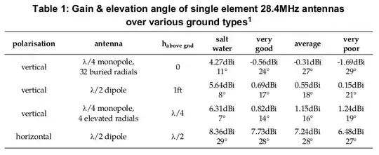

Modelling results
In January 2008, L. B. Cebik, W4RNL (SK) published what was going to be the last entry of his seminal 10-10 News series. It turned out to be an interesting gain comparison of single element 28.4MHz antennas modelled over various ground types of which a summary is presented here (Table 1). His findings seem to fit well with what John Devoldere, ON4UN modelled and published for equivalent antennas on the lower HF bands.
Gain & elevation angle of single element 28.4MHz antennas over various ground types
Horizontal HF antennas: near-by ground gain
At a height of about λ/2, the nearby ground reflection of a horizontal HF antenna will start to be constructive at interesting take-off angles for long- distance ionospheric contacts. This will provide a net gain over the antenna in free-space.

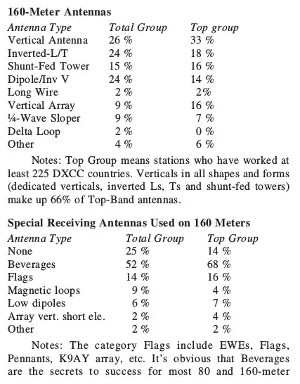

Horizontal.
However, one of the exceptions is 160 meters. If you are mostly interested on making longer distance QSOs (especially DX) contacts on 160, vertical polarization is best on that band. Period.
Check out this page. In a nutshell: What is effective on 160m are vertically-polarized antennas for transmitting, using separate antennas for receiving.
Per W8JI on qrz.com:
"Nearly all especially successful stations on 160 use a vertically polarized antenna of some type for transmitting. That's just a fact."
"The fact is....... an Inverted L with 20 or more radials at least 50 feet and hopefully 100 feet long will absolutely smoke any normal height loop antenna or dipole antenna at nearly any distance on 160 meters. The possible exception is between 20 and 200 miles."
"I have a full size 160 dipole at 300 feet, and it is never really much better than a 1/4 wave vertical at any distance in any direction. As a matter of fact, the dipole is 10-20 dB weaker than the vertical off the dipole ends. The dipole only beats the vertical broadside to the dipole, and then only rarely!! And this is with the dipole 300 feet above ground."
"As a matter of fact a low full wave loop has no gain, any horizontal wire has increased earth induced loss as it is made longer when close to earth."
http://forums.qrz.com/showthread.php?t=260716&highlight=beverage
Chart from ON4UN's Low Band Dxing,published by the ARRL
