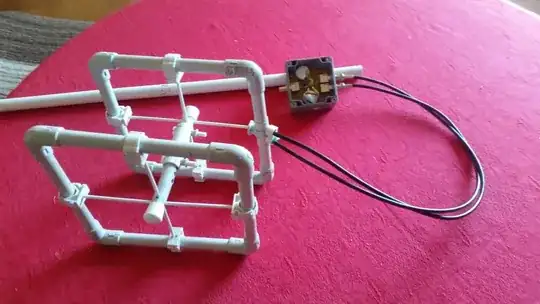

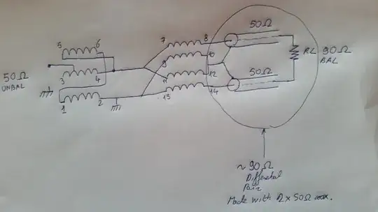

I've designed a two element UHF cubical quad. It was designed to resonate at 385 Mhz. I used 0.1mm thick and 1cm wide copper tape instead of wire to lower the antenna Q. I used PVC electrical conduit as a radome. Durapipe (ABS) would be better but i haven't that at hand. I used a 50 to 90 ohm balun (two stage design: trifilar followed by a guanella, based on Jerry Sevick W2FMI design). The transmission line to the balun uses two coaxial cables (using only the center conductor to make the loop legs, the shield is connect on the balun side to the center tap of the guanella). This feedline design part is experimental.

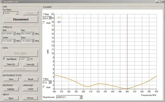

The analysis results are promising but the resonance is way off. (405 MHz instead of 380 and then a near perfect SWR at 460 MHz) the driven element loop is 0.79m long. I know that lowest SWR and resonance are not always matched — frankly i don't know.
So I wonder what may be the cause.

  • balun related ? (i used two turns around 37 cores (61 material), which is VHF UHF optimized it seems)

Any ideas? I have not tested the balun itself on two 50 ohm dummy loads yet.
Schematic of the balun and antenna pics attached.

    Have you tried to look at the input impedance on Smith chart? It might tell you something, especially if the imaginary part of impedance crosses zero near the intented frequency. Also, you could try to measure the input impedance from the point the wires are connected to the antenna (so without baluns and any matching network). – OH2FXN Aug 25 '19 at 15:13
  • yes indeed. the reactance is 0 at 388 mhz. and resistance is 18 ohm. so it may be wise to test with no balun or just a simple choke balun. since i have the same problem but to a way smaller degree with a vhf (fm broadcast band) I am narrowing down the problem on the ferrite behavior at uhf, number of turns on the balun and/or the double coax 50 ohm experimental feedline. when i'll test the balun on two dummy loads and on a 90 ohm resistor across the two center output connectors i should have more insight thanks! – rodv92 Aug 25 '19 at 16:35
1. You need to re-think your balun.
At UHF we don't use toroids and wire, it's always done with transmission lines of varying impedance, on PCB or maybe thin coax.

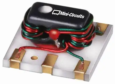

There are transformers for UHF, mini-circuits sells them, but they're tiny - the cores are say 2 x 4 mm and the wires hair-thin. Power handling is 0.25 Watts. Here's a photo/rendering - the pads are at 0.1" pitch:
minicircuits
Remember 433 MHz is at least 20 times HF frequencies, so you need to scale the balun down 20 times. Yours doesn't look small enough. With microstrip you can make a balun or transformer for hundreds of watts. This link has tons of photos of microwave and UHF stripline impedance matching.
You can measure your balun separately. Does your VNA have two ports?
Two 50-ohm coaxes make a valid 100-ohm transmission line.

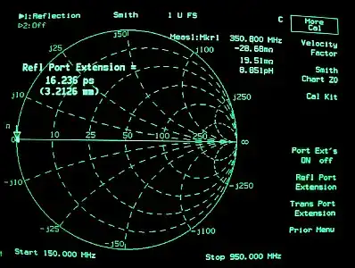

Edit: Now that I have a VNA, here's a worked example.
Here's a photo of a VNA with a port extension to achieve a (very good) short circuit:
vna
(from this very relevant article about measuring impedance of loops)
By the way, unless you have done a port extension like this, it's meaningless to talk about the impedance, resonance, etc - the only valid quantity is reflection magnitude, or SWR. An unknown length of cable "winds up" the impedance on the Smith chart, so you can't actually say if it's high or low, capacitive or inductive. This obsession with "resonance" on a test instrument at the end of a cable.... /rant

    thank you for the very informative post. I checked the balun on a dummy load.in the range of 350 to 400 Mhz the Xs is capacitative and relatively flat xs = -24 Rs = 46. Using a tool that calculate the resultant s1p for the input s1p + a matching network, it seems that to cancel the reactance without changing the Rs, a 10 nH inductor should be placed in series (just after the input port). I will try to make a little copper loop after the connector to see how it affects the response. – rodv92 Sep 18 '19 at 11:43
    "without changing the Rs at 385 Mhz" i meant. – rodv92 Sep 18 '19 at 11:50
  • I will proceed to test s21, s31, and s23 s32 too. – rodv92 Sep 18 '19 at 11:52
