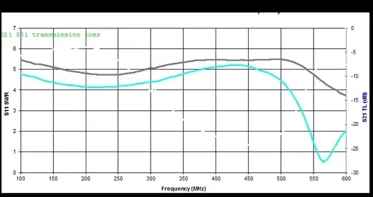

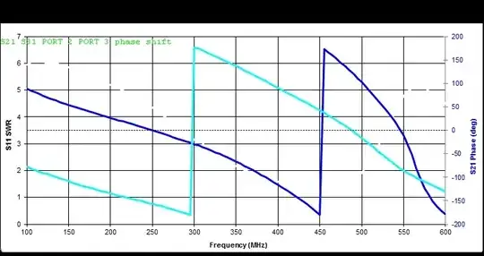

This is a S21 and S31 analysis of an oversized 385 Mhz 50 Ohm to 90 Ohm balun between 100 Mhz and 600 Mhz I tested phase separation and transmission loss for both ports.
If I interpret the results correctly, phase separation is pretty good over the 300 - 400 Mhz range. Transmission loss however is not good (more than 6dB loss, ideal should be 3dB loss) with one port more lossy than the other. I did not compute the common-mode rejection yet, I know there is a simple formula to calculate it from the VNA data. I did not test port isolation.
