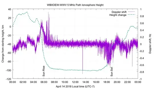

Doppler spreading is the change in received frequency from a distance transmitter due to the rise and fall of the ionosphere along the signal path. When the effective height of the ionosphere rises, this lengthens the path and causes the received frequency to drop; when it falls the path decreases and the frequency rises.
You can measure this frequency change yourself in real time using simple equipment and, making some simple assumptions, compute the change in ionospheric height. The equipment and technique are both described in my Sept 2018 QEX article available here. The idea is to use a digital frequency synthesizer synchronized to GPS, then record the difference between the locally generated signal and a signal with a well-known frequency such as WWV. Then assuming the path is a simple triangular up-reflect-down profile, the change in frequency can be used to compute the change in path length and thence the change in ionospheric effective height.
My measurements suggest a 5 MHz frequency measured over a 1000 km path changes a few tenths of Hz during stable day and night periods, but can change up to half a Hz or more during twilight when ionospheric recombination (dusk) or excitation (dawn) is changing rapidly as the sun sets and rises over the path. These correspond to changes in the effective ionospheric height of a few tens of km.
