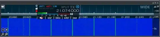

Every 61khz precisely i have solid bars on 20M and 15M (40M is clear), that look like this:
15M screenshot

Further research has revealed the origin of the 61 kHz spacing between the RFI carriers.
100BASE-TX uses a 125 MHz clock, which is divided by 2047 in a scrambling circuit.
This is intended, ironically enough, to reduce EMI by spreading the signal across a wide portion of the spectrum, rather than generating very strong peaks at frequencies such as 31.25 MHz (125 MHz / 4) which would otherwise be generated by the MLT-3 coding scheme used. 125 MHz / 2047 = ~61.064973 kHz, explains the spacing of the offending signals.
Additionally, I have found similar carriers offset by 1/2 of the expected 61.06 kHz spacing in certain portions of the spectrum. This appears to be particularly pronounced in the upper HF and VHF region.
UTP Cat 5 or Cat 5e should absolutely never be used for anything higher than 10 Mbps Ethernet, especially in an environment where any type of HF or VHF receiver will be used.
Note that gigabit Ethernet generates a similar overall spectral profile, though with different modulation characteristics; it appears to generate more of a broadband hash than discrete carriers, but still causes interference.
Take a handheld radio with HF receive coverage and a VHF/UHF rubber duck antenna, and tune it to 14.275 MHz AM. It may be necessary to open the squelch on the radio. Hold the antenna next to an Ethernet cable with an active 100 Mbps connection on it, and there is virtually guaranteed to be a strong signal present.
Move the antenna along (and perpendicular to) the cable slowly, and the signal will increase and decrease in strength several times per inch of cable. This is literally a result of each individual twist in the twisted pair converting some of the differential signal into common mode radiation. The worst offenders can be heard for some distance away from the cable, even with such an intentionally insensitive receive setup.
Note that shielded Cat 5 or 5e (if properly terminated), as well as quality unshielded Cat 6, do not generate nearly as much interference.
I recently discovered that even some unshielded Cat 6 cable is capable of radiating considerable RFI. As already dictated by common sense anyway, shielded cable is simply the only way to go to assure a clean installation.
Credit to KA3RCS's work.
