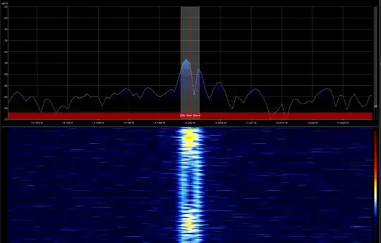

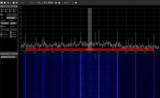

I'm very new to shortwave listening and just got to grips with my RTL SDR HF dongle. Last night while on the 20m band, there were signals exactly every 50kHz, starting exactly at 14.000MHz, then at 14.050 MHz, 14.100 Mhz and so on. Google said they may be my power supply. Today I wanted to troubleshoot them but they are mostly gone, making me even more curious to what they could be as I have exactly the same electrical equipment on today.
RTL-SDR Waterfall showing signals every 50 kHz
Here's a close up of the one that was at 14.200 MHz

Those equally spaced lines in the waterfall are very likely from EMI/RFI noise generated by modern electronics, often harmonics and/or intermodulation coming from DC-to-DC power converters. Could be something inside an LED light or lightbulb, USB charger, wall-wart switching power supply, computer peripheral or network hub, video monitor, solar panel, or almost any modern appliance in either your house or a neighboring house or building. If you shut off the main circuit breaker to your house and those lines go away, the noise source is likely in your house. If not, it could be something radiated from a neighboring building or power pole. If it is in your house, you could go room-by-room, unplugging things until you find (one of) the sources.
If the lines went away, it could be someone unplugged something or turned something off.
This has become a common problem the last few decades in any urban or suburban locale where modern electronic devices, appliances, or lights are in use. Much of that hash between the equally spaced lines is likely more of the same, just a mashed up mix at lower levels.

You're picking up interference from some sort of electronic device that has a component producing a 50 kilohertz wave. Since this appears to be dead-on accurate down to a kilohertz or less, it's probably controlled by a quartz crystal. Any time a signal is produced at some frequency, there is almost always other signals produced at integer multiples of that frequency, called harmonics. At 14.050 MHz, you're seeing the "280th harmonic" of 50 KHz.
To find this, watch the display as you go around the house unplugging literally everything. In my case, it was the fancy new washing machine we bought! Also take the batteries out of everything. The 280th harmonic of something is going to be really weak, and you're picking it up full-scale, so it's probably something really close by.

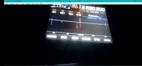

Vizio[![enter image description here][1]][1] inexpensive Chinese TV First of all I sincerely apologize for the terrible picture quality. Had my laptop camera pointed my radio and used the screen recorder on Android well viewing remote desktop. I ran around the whole house unplugging the everything. Finally figured out it was the cheap Vizio TV. When I turned it on it at the bars all the way across my waterfall the last photo is me turning it off.
