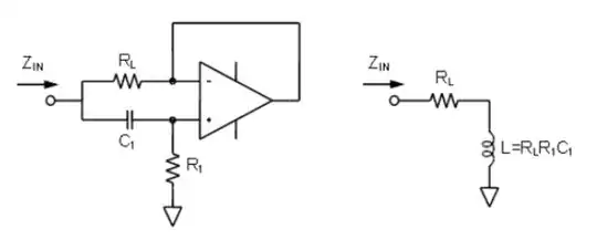

A "simulated inductor" might work in your application:
You could adjust the simulated inductance by using an analog multiplexer IC and resistive ladder array IC to change the values of RL and R1.
Brian K1LI
  • 7,808
  • Does this work for an FM transmitter at 100 MHz? I don't think so.... –  Mar 21 '21 at 12:50
