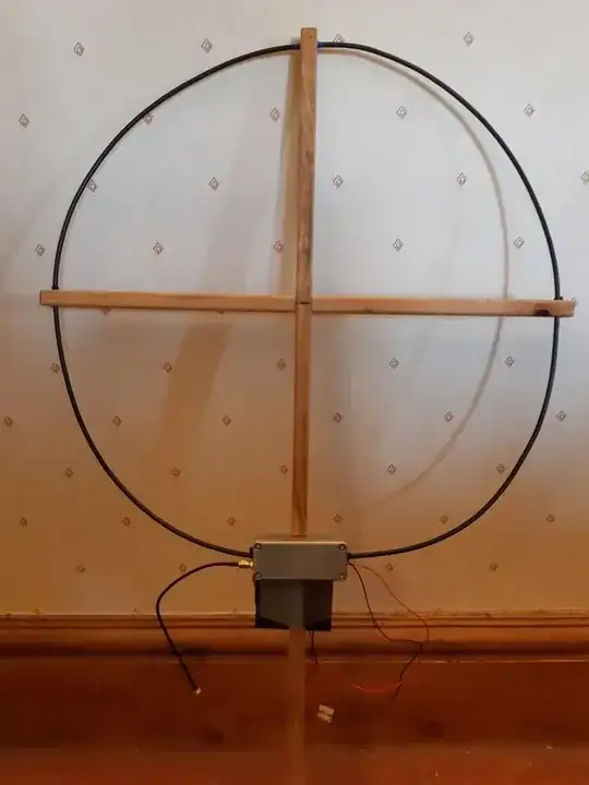

Update#3: First test results with loop - hard to interpret: This is the Loop: enter image description here

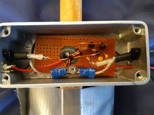

And the preamp: enter image description here

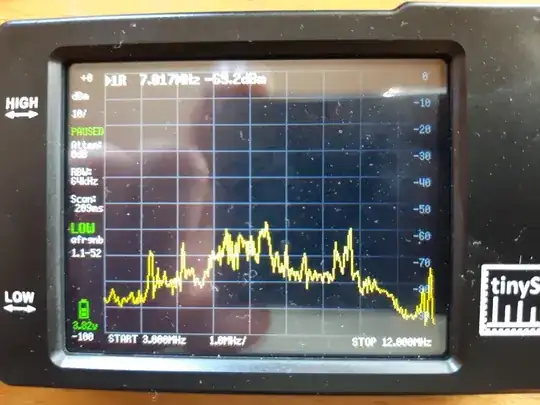

And the tinySA fed from my dipole from 3-12Mhz, clearly showing the raised floor that I am also seeing on the S-meter. enter image description here

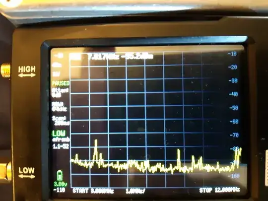

And the tinySA showing the signal from the amplified loop standing under the dipole.
The loop is clearly working and showing signals. And these can be nulled by rotating, but it does not show the "raised floor". Why? I am not sure how to interpret this.
