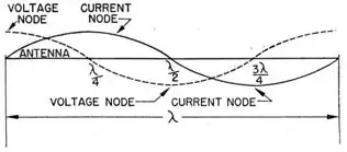

For a dipole to me this means that resonance occurs when an AC source is applied with frequency that has a wavelength which allows an increase in the amplitude of the standing wave on the antenna to occur, because the applied source "tops up" the circulating energy at exactly the right moments, due to the resonant length.
Everyone knows that a center fed resonant 1/2 wave dipole has a feed point impedance of about 70 ohms with no reactance.
My understanding is that there is no reactance because the length of the elements results in the current of the standing wave at the center feed point being in phase with the applied source, and the voltage of the standing wave at the feed point (which is always about 90 deg out of phase with the current of the standing wave everywhere on the antenna), is at the zero cross over point and so contributes no reactance to the feed point impedance.
So the impedance is low with no reactance.
My understanding is that only for a resonant dipole does there exist any points where if split at those points and used as the feed point there will be no reactance.
For dipoles which are odd multiples of a 1/2 wave of the frequency of the applied source in length, the points where there is no reactance are at the current maximums or current loops, because it is at those points that the current is in phase with the applied votage source and the out of phase voltage is at the zero crossing point.
For a full wave dipole with feed point at the center, the voltage of the standing wave at the feed point is in phase with the applied source and at a maximum value, whereas the current is 180 deg out of phase with the source but at the zero crossing point.
This means the feed point impedance is high with no reactance.
So to me it seems that a full wave dipole is a resonant antenna, and if the feed point is in the center it has a high non-reactive impedance.

Let's consider a simpler case by bringing the tips of a half-wave resonant dipole together so the two wires of the dipole are parallel, making a quarter-wave section of of balanced transmission line. Let's also assume the line is lossless. We might also need to adjust the length a little bit to ensure it's still electrically a quarter-wave, because the velocity factor of a dipole and a balanced transmission line are not be the same.
Now if you apply a wave to this transmission line stub, there must be a reflected wave. 100% of the power must be reflected because the line is lossless and there's nowhere for it to go. What's the phase of the reflected wave, relative to the forward wave?
  • There's a 90 degree delay traveling from one end to the other end.
  • The open circuit at the end has a reflection coefficient of -1, so that's a 180 degree shift.
  • There's another 90 degree delay traveling from the open end back to the "feedpoint".
90 + 180 + 90 = 360, so the reflected wave is in phase with the forward wave. Let's say the characteristic impedance of this transmission line is 200 ohms and it's being driven by a 1V (RMS) voltage source. The current at first will be 5 mA. After half a cycle the first reflected wave has arrived which is in phase, so the 5 mA of current from the reflected wave adds to the forward wave and now the current is 10 mA. Another half wave later another reflection has come back, and now the current is 15 mA. Every half wave the current increases another 5 mA, approaching infinity.
So 1 volt can move infinite current: that's zero impedance.
Now if you make the transmission line an additional quarter wavelength long it would make a full-wave dipole if you pulled the tips apart. An additional 180 degrees (90 there, and 90 back) of delay has been added, so now the reflected wave is out of phase with the forward wave. That initial 5 mA of current is cancelled, rather than reinforced by the reflection.
So the 1 V source drives zero current. That's infinite impedance.
Now the only difference between a dipole and a transmission line like this is the dipole has been zippered apart. This makes it radiate, which is like a "loss". So the impedance isn't zero or infinite, it's just low or high because the reflected waves don't quite reinforce or cancel the forward wave completely. In any case the reactance is zero.
