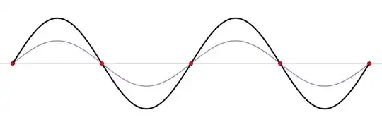

But for most amateur transmissions, we can consider the transmission as a pure sine wave, which is a reasonable approximation given the timescales dictated by the length of the feedline and the modulation. Then, it helps to visualize what a standing wave in the feedline looks like. From Wikipedia:
If we regard the transmitter to be on the left and the antenna to be on the right, then the blue wave represents the transmitted wave, and the red wave the reflected wave.
Now here's the thing to realize: this particular image depicts a complete standing wave on a lossless transmission line. In this case, we are delivering 0 power to the antenna, the VSWR is infinite, and the transmitter's finals are probably about to explode. This doesn't happen in practice because our antennas always accept at least some of the power.

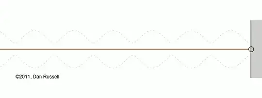

In practice, only some of the power is reflected back, and the result is a partial standing wave. Dan A Russel has a page of great animations, like this one:
In the case of a partial standing wave, we can see that the envelope (outlined by the dotted lines) does not reach 0 amplitude at the nodes. In this case, some power is transferred. This is also a good visualization of VSWR: it is the ratio of the voltage amplitude at the antinodes (envelope maximums) to the voltage amplitude at the nodes (envelope minimums).
Notice also that the reflected wave might arrive back at the transmitter in any phase, depending on the length of the feedline and the antenna's reflection coefficient. It may or may not be in phase, but it will be a constant phase, not just noise. By adding an antenna tuner we can reflect the reflected wave back at the antenna, and adjust the phase of this re-reflected wave to be whatever we want, within the limits of the tuner's capabilities of course.
