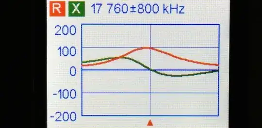

I've not personally built antennas from scratch, but I appreciate my antenna analyzer just for being a good instrument — making the invisible aspects of my antenna system visible.
Compared to using a SWR meter for the purpose, an antenna analyzer:
  • Displays more information.
    A SWR meter still gives you enough information, in the sense that you can try things until they move towards 1:1 SWR, but it's a one-dimensional measurement: if you tried to adjust an antenna using it you're doing a “hotter colder” search, trying things until it improves.
    An antenna analyzer will tell you resistance and reactance independently, which allows you to more directly understand the problem. For example, you can have an exactly resonant antenna, which simply has the wrong magnitude of impedance (you need an impedance transformer). On a SWR meter this can show up as the SWR having a minimum point but remaining well above 1:1. (That minimum point is not necessarily the resonant point.) On an antenna analyzer, you can immediately see that you've got R = 34 Ω instead of 50 Ω (or whatever), and build that correction into your balun.
    High-end antenna analyzers can also give you measurements at multiple frequencies — either as a graph or individual readings at selected frequencies. A graph allows you to easily obtain measurements in the opposite direction — not “how suitable is this antenna at this frequency?”, but “what frequencies is this antenna good for?”, as well as other RF-electronics measurements like finding the resonant frequency of a circuit or the upper frequency limit of a ferrite choke.
    In the above picture: my RigExpert AA-600 antenna analyzer displaying an impedance graph (it can also compute SWR from the same data). You can see directly from this graph that whatever it's connected to is resonant at the frequency at the middle of the graph (reactance crosses zero) and at that point has a resistance (and also magnitude of impedance) of 100 Ω.

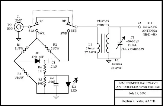

An antenna analyzer is not necessary. Sure, it's handy. A VNA is even handier. For this equipment you're looking at something like $50 USD for a NanoVNA, up to many thousands of dollars for a lab grade VNA. If you just want to know if you need to trim a bit off a wire dipole or not, and simply get on the air without toasting your transmitter, none of these things are necessary. While there's a certain joy in being able to measure and quantify exactly how things are operating and make it all "just so", radios are in fact quite forgiving. An AC current wants to radiate. In fact, there's an entire industry around making things not radiate.
If you wonder how to make an antenna without these tools, you need only look to the recent past. It wasn't that long ago that we did not have solid state electronics, and test equipment like we have today was either very expensive, or nonexistent. Most of the methods used in those days to measure antenna impedance involve putting an antenna in some kind of bridge and comparing it against a known impedance.
Here's one example of a dead-simple approach:
You can read the full question for an explanation of how it works. It's not particularly sophisticated, but if you just need to trim your antenna until it's not a horrible match to 50 ohms, it will work just fine. If you have an SWR meter, you can also just adjust for minimum SWR and accomplish the same thing. Note you don't need the matching section (L1, L2, and C3) if you just want to measure impedance.
If you want to take the sophistication up a notch, you can use a grid dip meter. You can find them at any hamfest, or used on eBay or whatnot for some tens of dollars. Just a few decades ago, these were state of the art antenna test equipment. The physical laws that govern their operation have not changed, and they work as just well today.
As another step up, you can consider any number of used impedance bridges which are similar in concept to the schematic above, but have adjustable and calibrated inductors and capacitors so you can measure the complex impedance of the antenna. This is in effect what an antenna analyzer does, the only difference being that the antenna analyzer will automatically adjust the knobs for you, and maybe measure impedance at a range of frequencies at a push of button.
