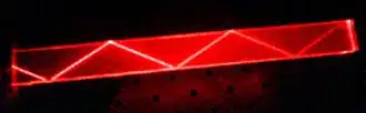

Skywave propagation is closely related to total internal reflection. This is easily demonstrated with visible light (which is also electromagnetic radiation) through a block of acrylic:
Total internal reflection occurs when the angle of incidence is above a critical angle, which is a function of the refractive indexes of the two materials:
$$ \theta_c = \arcsin\left( n_2 \over n_1 \right) $$
As the angle of incidence decreases beyond the critical angle, some of the incident wave is refracted and passes though the interface, and less of it is reflected. Obviously for terrestrial communication we want to maximize the reflected part and minimize the refracted part.
You can observe total internal reflection and refraction with something as simple as a glass of water. At some angles, it will look like a mirror. At others, it's almost transparent. For communication, we want it to look like a mirror, or as close as possible.
