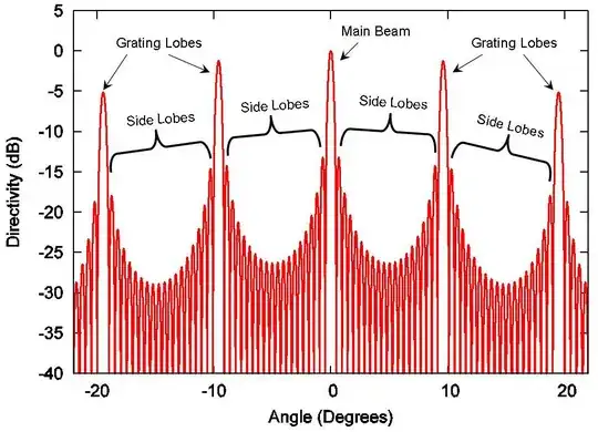

Effectively, the transmitter's antenna pattern has been modified to have a large number of narrow lobes. These are called "grating lobes" in the context of phased arrays:
Typical antenna pattern with grating lobes "Typical antenna pattern with grating lobes" by Mr. PIM at the English language Wikipedia. Licensed under CC BY-SA 3.0 via Wikimedia Commons
Notice how between the 5 large peaks, there are very many smaller peaks. Depending on the multipath geometry, there might be very many such peaks, and the receiver might not need to move very far from being in one of the peaks to one of the nulls.
