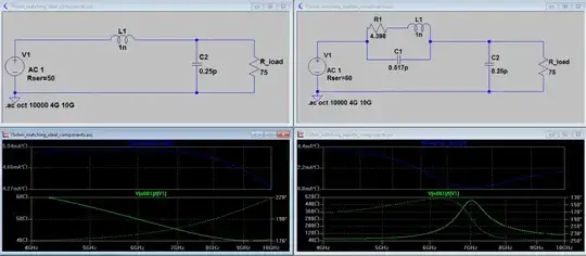

Long story: While the transmission lines might be better for practical applications, I wanted to share the simulations I did for this problem to help to understand the challenges. Consider a $75 \Omega$ load that you want to match to $50 \Omega$ source. Most practical loads would have also a imaginary component and vary as function off the frequency, but constant resistance will do nicely in this example. One solution, at 6 GHz, would be a 0.25 pF parallel capacitor and a 1 nH series inductor. The left hand side of the figure shows a maximum in the power transmitted to the 75 $\Omega$ load resistance R_load (blue curve) and that the feed impedance is $50 \Omega$ at 6 GHz (green curve). This means that the load got matched at that frequency.
In reality, the 1 nH inductor has also some capacitance between the legs and windings (C1) and some resistive losses (R1). See the right hand side of the figure. Parallel inductor and capacitor in series with your load create a band stop filter: low frequencies cannot pass the capacitor and the circuit seems like inductance. At high frequencies the circuit behaves like a capacitor. In the middle, at the resonance frequency, the impedance is very high and no current can flow through the circuit.
The self resonance frequency found on the datasheet of the inductor corresponds the frequency at which the inductor starts to behave like a capacitor, that is, above the resonance frequency the parasitic capacitance of the inductor is the easier path for the current flowing through the component.
The component values for the better model of inductor can be calculated from the equations. Parallel capacitor from the self resonance frequency: $C = 1/((2\pi f_{res})^2L)$. And equivalent series resistance from the Q value: $R = 2\pi f_{res}L/Q$. The simulations show that with all non-idealities taken into account, the matching circuit is quite horrible and also the power delivered to the resistor has dropped significantly.
Left: matching with ideal inductor. Right: Inductor replaced with more realistic one.

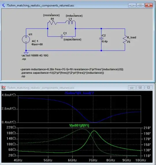

The situation can be improved by optimizing the matching network while taking into account the non-idealities of the inductor. The figure below shows one solution: it turned out to be impossible to get the circuit tuned with 0.25 pF parallel capacitor: if the inductor value decreases and SRF is constant, the value of parasitic capacitor gets up and the circuit is newer matched to $50 \Omega$. For practical inductors, this probably would not be the case: by removing turns from otherwise identical inductor the capacitance would actually drop. A few sample inductors from Farnell had tolerances of e.g. 0.5nH $\pm$ 0.2 nH.Re-tuned circuit.
