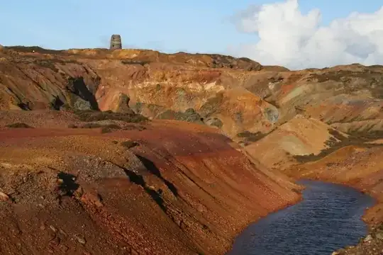

Well, I operate daily from an old copper mine - where the main mineral is iron!
The comment about iron oxide are not correct. In places such as here, and where the OP mentions, the ground is highly acidic. Consequently, iron is in the FE2+ (ferric) state, not the FE3+ (ferrous/rust) state. This may or may not affect conductivity. You will have to consult a number of detailed academic papers on that, probably none of which are in the context of RF operations.
When one comes across 'red water' (pH above 4, and so iron in the precipitatable, Fe3+ state), then you know you are likely in an area with lots of different types of mineralisation. Picking out the role of each, and when geological layering and water in and through these is present, is a task that quickly leads to madness!
Are you better off with highly conductive ground under your antenna? Yes!
Parys Mountain, a Kuroko-type mineral deposit
