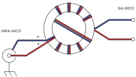

At http://vk6ysf.com/balun_guanella_current_1-1.htm a design is given for a 1:1 current balun that simply wraps a pair of wires around a toroidal core:
Simple bifilar winding around toroid, unbalanced in and balanced out

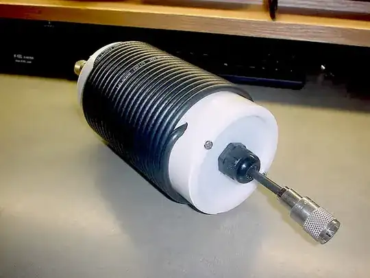

I suppose the air-wound "ugly balun" as demonstrated at http://www.hamuniverse.com/balun.html also fits in this same category, unless using coax in place of the bifilar winding somehow changes things?
Coax wrapped repeatedly around a large-diameter PVC tube

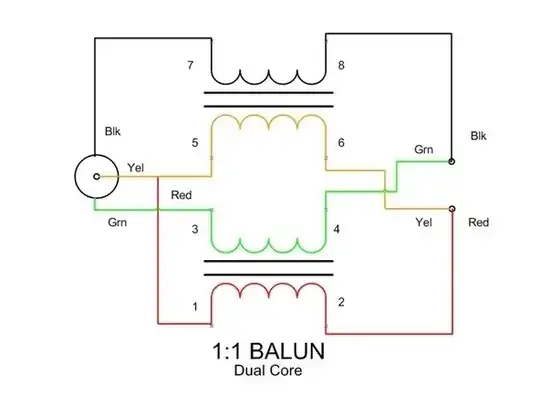

But then — under the same "Guanella balun" name as the first diagram above, no less! — I find that http://www.kn9b.us/guanella-balun presents this diagram:
Schematic of a 1:1 current balun using two bifilar windings on two separate toroids

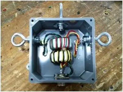

…which is to be built using two toroids resulting in something that looks like this:
Current balun using two toroids, assembled in a project box

  1. Starting from the top: That design should in theory work fine, except the website is using a toroid for which I can find almost no tech data, and what little is available in the data sheet suggests it's meant for SMPS transformers and the like. This means it is quite likely to saturate, or potentially just not offer much of any choking impedance at higher frequencies. You might be able to justify using it for 160m, maybe even 80m, but above that, it's almost certainly at best ineffective, and at worst, very inefficient. Even on the lower frequencies, given the type of transformer they're typically used for, I suspect that choking impedance would be quite low.
    The counter winding technique is also at best needlessly complicated, and at worst can act to increase parasitic capacitance within the transformer, causing a reduction in performance, not the commonly claimed improvement. W8JI, K9YC, and VK1OD all failed to find any evidence of the supposed elimination of saturation with that winding style, in reality it likely just causes a complex eddy current which may lead to localized saturation in some areas of the toroid but not others.
    This design with a Type 43 or Type 31 (Amidon, Palomar, or Fair-Rite) T106 core would be fine for 40m and up on QRP, T200 or larger for 100w, especially if you want to operate below 40m). IIRC Type 77 or type 62 is typically recommended for frequencies from 10m to 2 meters.
    Ditch the counter-winding technique, it's pointless and just complicates things. 14-18 bifilar turns of 18-14awg wire should do the trick for most of HF on the T240 cores.

  3. Third is a classic "Ugly balun" or air core solenoid balun. They CAN work, however because capacitance in the coil is quite high (without looking, I believe RG-8X is ~5pF/ft), they are self-resonant tank circuits. This means that they can present quite useful impedance on a couple of bands at most, but otherwise may be all but invisible on other bands. They can be strung together along the coax, but you end up using a lot of extra coax that equates to more loss, and it's far more expensive than just buying a proper toroid for $5.
  4. The final design is a bit of a novelty to me, and is rather puzzling. It's done in the manner of a proper 4:1 current balun, and there's no reason it wouldn't work, but the design is counter-productive. Electrically the two cores are in parallel, acting as two parallel bifilar chokes. Presuming they are identical cores and windings, this will actually reduce choking impedance.
    There doesn't seem to be any logical reason to do this unless you're constructing a balun to handle a lot of power, 500w or more, but then you'd still want them in series, just with less impedance per core. I suspect that the designer has read the technical discussions on why single core 4:1 voltage baluns are not baluns at all, but impedance transformers that provide little, if any, useful feedline isolation, and just took that to mean that you can't achieve isolation in any situation with 1 core. That statement only applies to a 4:1 balun due to the DC short that is present. A 1:1 bifilar winding is more than capable of providing good isolation on a single core on a wide range of frequencies.
    A single T240-43 with 14awg magnet wire should be more than capable of dissipating the common mode current from even a moderately imbalanced antenna at 500w PEP without issue. The only reasons I can imagine using this final design this would be to compensate for poor component choice (saturation, perhaps) and perhaps it's an attempt to reduce the total current through each choke, or if he were using two different cores (it doesn't look like he is) to provide good choking impedance on two different frequency ranges, but again, they should be in series, not parallel.
    That's another one that seems to needlessly complicate the situation because of a failure to grasp the basic qualities that a choke balun (as opposed to a true isolated winding transformer) should have.

  • I think the final balun is designed to guarantee balanced equal voltages on the outputs. A choke balun, the other three, doesn't guarantee this at all, it just presents an impedance which you hope is higher than that of the antenna. If your feedline+shack is antiresonant at some frequency, the balun might fail to choke anything and a lot of power could be transferred. Agree it will have a lower impedance. – tomnexus May 04 '16 at 19:31
  • The last design is a simple choke, and offers no balance over a single core. 2 parallel, DC open, 1:1 bifilar chokes, there is no cross talk between the two conductors as there is on a 4:1 two core design. It's just a weird choke, not a transformer. Chokes are of limited use when the antenna is high impedance, but then common mode current is likely to be small in magnitude, and the range over which a typical balanced dipole will exhibit impedance of >3,000 ohms is quite narrow usually. In that case, a true narrow band transformer is probably the only option that will be really effective. – Hamsterdave May 04 '16 at 23:19

  • @hamsterdave You're right, it is just a choke. No transformer benefits. One thing you do get from two windings on two cores is that the characteristic impedance of the transmission line is effectively 50 ohms, not 100 like any simple bifilar choke. Perhaps there's some advantage for feeding a low impedance resonant dipole or yagi driven element, up at 30 or 50 MHz? – tomnexus May 06 '16 at 04:48
