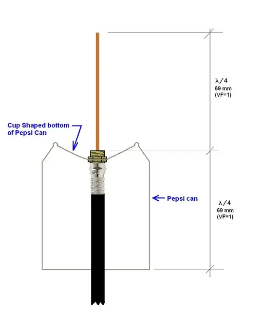

A post on http://adsbexchange.com/forums/topic/beginners-2-cantenna-easy-diy-antenna-to-improve-rangeplane-count uses a $\frac{\lambda}{4}$ sleeve made of a pop can beneath a $\frac{\lambda}{4}$ wire protrusion made from the core of a coaxial cable (coax with shielding removed). The protrusion connects to an SMA F connector that's lodged in a hole through the base of the popcan which in turn connects to regular coax that emerges from the bottom of the pop can. enter image description here
My question is -- Why does the length of the sleeve (the pop can) matter considering that the coaxial cable enclosed by it is completely shielded?
EDIT : Considering the comments below RE: inclined ground plane. It seems to me that the desire of the author is to impedance match to 75ohm coaxial cable. See the image below: enter image description here

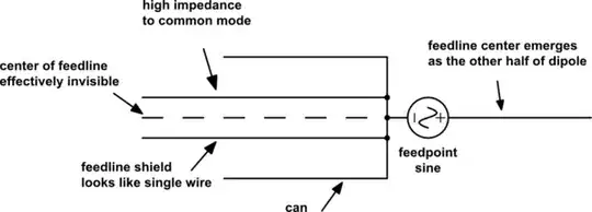

Lemma: this antenna is a dipole with one leg of it acting as a balun. Specifically, a bazooka balun (AKA sleeve balun).
Whenever you want to feed a dipole with coax, you have to do something about common-mode currents. The trick is, one way or another, to make the common-mode currents on the coax a high impedance. Hopefully there's a much lower impedance path somewhere (like, the dipole you're trying to feed) and so there won't be much common-mode current.
How does it work?
First, consider that differential-mode currents on the feedline are irrelevant to anything outside the feedline's shield since their associated fields cancel. For now, let's simplify the situation by ignoring the antenna and assuming an infinitely long feedline. And let's also ignore the inside of the feedline and consider it just a fat wire. Here's a simplified view, in cross-section:
schematic
simulate this circuit – Schematic created using CircuitLab

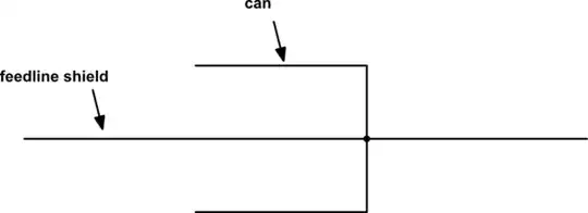

Further, the feedline shield and the can together form another coaxial transmission line, with the feedline shield as the center, and the can as the shield. We will call this the can-coax. This transmission line is shorted at one end, and open at the other. It's a quarter wavelength long, which hints this may be a quarter-wave transformer.
Next, consider that at the open end of the can, any common-mode current on the feedline must become a differential-mode current on the can-coax. Because, only a differential-mode current can possibly flow on the center of a coaxial transmission line.
So effectively, the common mode is in series with a shorted, quarter-wave stub:
schematic
By the properties of a quarter-wave stub, the short at one end is transformed into a high impedance at the other end. Thus, the common mode is in series with a high impedance. QED.
schematic
Meanwhile the outside of the can is free to function as a fat, tubular leg of a dipole. Put it all together and you get:

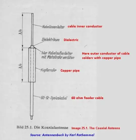

Bah. Humbug. For reference, the picture on which they base this design:
Coaxial antenna
Is clearly simply a $\frac\lambda2$ dipole, meant for coaxes fed with a symmetric/ balanced signal, or producing one. The more alike the width of the tube and the upper copper antenna part are, the more "ideal" the dipole becomes.
In the way they use it here, the copper pipe is part of the ground part of an unbalanced receiver. So, this simply is not going to be great. What you want, as discussed in the comments, is a ground plane for a $\frac\lambda4$ monopole. And 45° radials is a well-proven, well-tested, pretty-close-to-perfect, foolproof way of implementing a seemingly endless ground plane.
For the length of the can in your picture to have effect, there would be the need for a current to flow in the lower parts of that. But that current can only flow if the can is not doing its job of simulating a perfect "E-field mirror" overly well (otherwise the energy "reflected" back into the upper half-space would be 100% of what incides at any point of the plane, and since the monopole is the only driven element here, it would surprise me if the currents induced at the part where the bends start actually help very much with making this a better antenna.
So, yes, they'll be getting better reception with that at 1090 MHz than with the stock TV antenna, but that's not hard. Simply replacing the $\ne\frac\lambda4$ monopole of that (e.g. by cutting it to the right length...) and placing the antenna on a conductive (magnetic, if possible, that's why it has a magnet in its pedestal) will probably do even better.

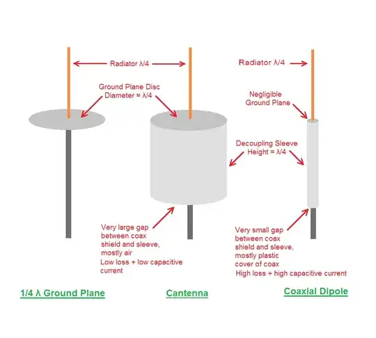

CANTENNA IS HYBRID OF 1/4 λ GROUND PLANE AND 1/2 λ COAXIAL DIPOLE.
In Coaxial Dipole, the sleeve (copper pipe) serves following functions:
(1) Lower limb of Dipole.
(2) Decoupling Sleeve/Sleeve Balun, but due to very narrow gap between coax shield and pipe, mostly filled with high loss outer plastic of coax, resulting in high loss.
In Cantenna the Soda Can performs following functions:
(1) Upper surface of circular bottom acts as ground plane disc.
(2) Cylinderical wall + lower surface of circular bottom acts as Decoupling Sleeve/Sleeve Balun, with a very large gap between coax shield and can wall, mostly filled by air, the losses are negligible.
Cantenna: Whip = 1/4λ, Dia of Can = 1/4λ, Height of Can = 1/4λ

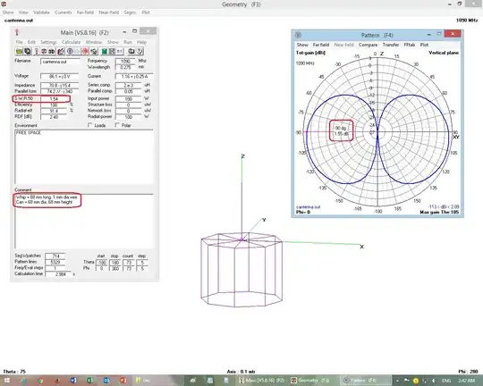

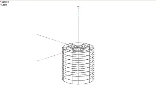

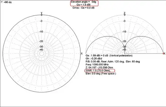

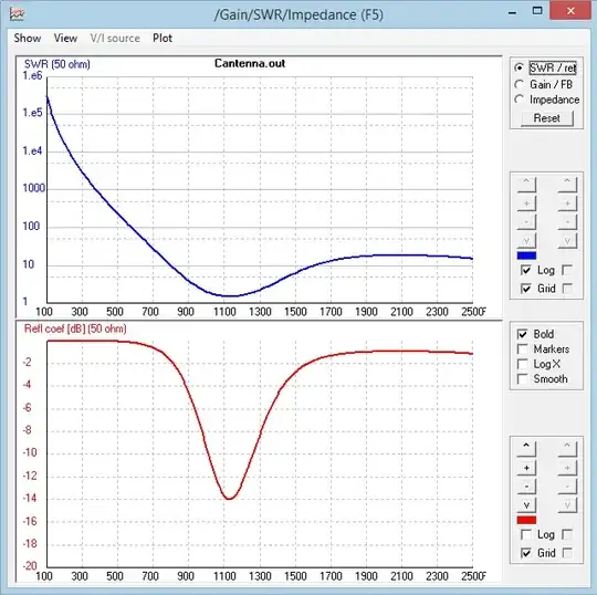

Simulation 2 of 2: CANTENNA Gain = 1.9 dBi SWR (75 ohms) = 1.5
abcd567
  • 389
  • The model should probably include the feedline extending down from the feedpoint and the middle of the can to illustrate the common-mode choking. I'd guess you'd then be able to illustrate how the efficacy of the choking is dependent on frequency. – Phil Frost - W8II Jan 25 '17 at 14:53
  • @abcd567, with what software did you simulate that? – KJ7LNW Dec 04 '20 at 20:19
  • @KJ7LNW, I used software MMANA-GAL BASIC (free of cost). Go to this page http://gal-ana.de/basicmm/en/ and scroll down to bottom to find download link (http://gal-ana.de/basicmm/download/download.php?mm=2) – abcd567 Dec 06 '20 at 10:22

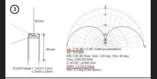

Frequency Sweep (From 100 MHz to 2500 MHz) of 1/4 Wavelength Cantenna.

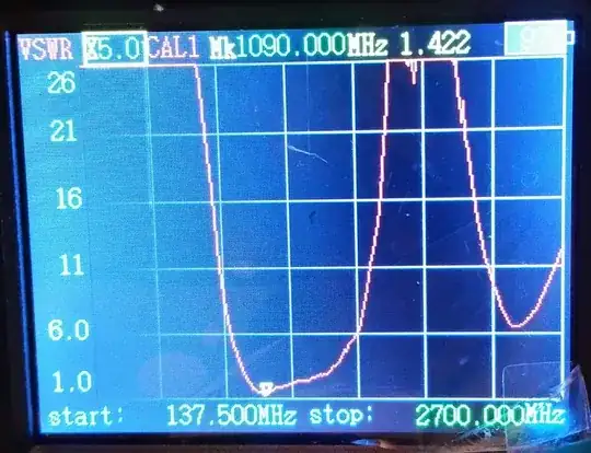

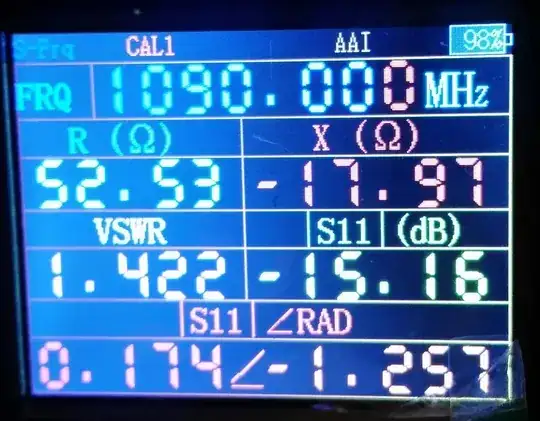

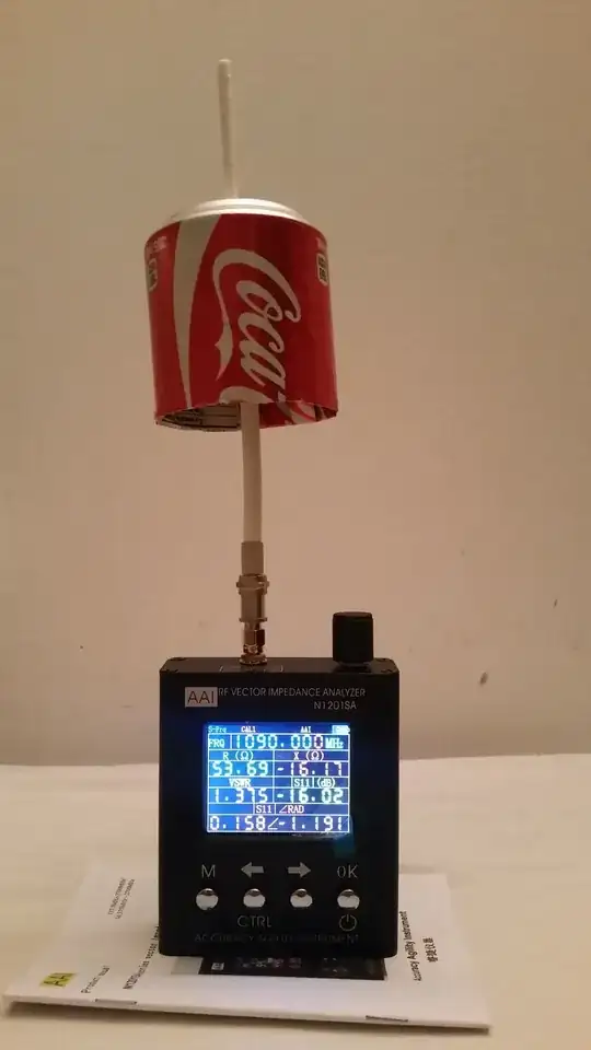

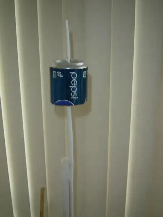

Results of measurements done today (January 24, 2017)
These results show that this antenna performs well at its designed frequency of 1090 Mhz. However it has low gain (≈ 1.5 to 2 dBi).
Test Setup
test setup
Frequency vs VSWR VSWR vs Frequency Sweep
R, X, S11,VSWR R,X,S11, VSWR
