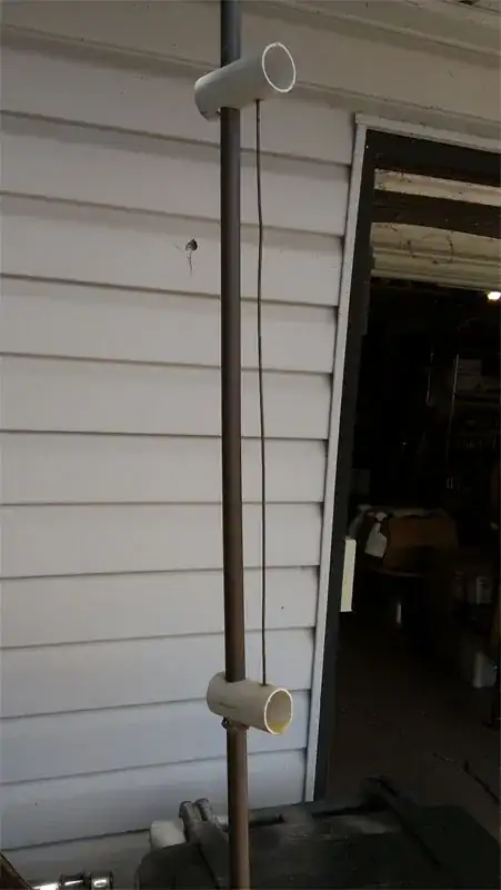

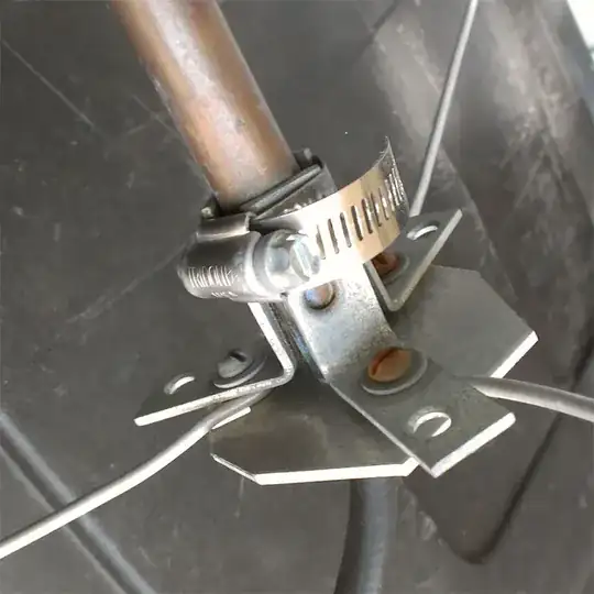

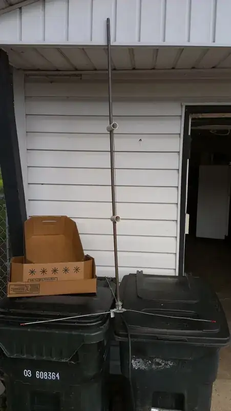

At first glance this appears to be a simple ground plane but there is far more going on. The ham who built this back in the '80s is now SK and I can't find anything else like this anywhere. The radials are 19" in length, as is the vertical radiator. The copper vertical element is 60" tall.

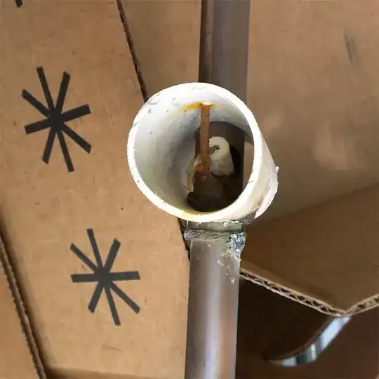

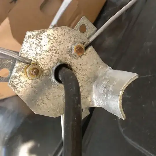

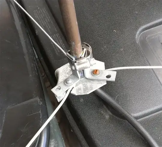

The shield of the coax is wrapped around and soldered to the copper element and the center conductor is soldered to the 19" element that is suspended in the PVC insulators.
Any ideas on what exactly is going on here?
Edited to add: I've tested this on both 2 meter and 440 and get SWRs no higher than 1.5:1 on either band with 440 being slightly better.
With the antenna mounted at 15' high, I am full-quieting into 2 meter and 440 repeaters 12 miles distant on 5 watts. I did not test for directionality.
When originally in use, it was mounted in an attic. It was never meant to be in the weather for any length of time.
The antenna Bottom Bottom Underside Radiator Connection

  • Please let me know if I should post this as a new question, referencing this one... I'm thinking about replacing the RG-8 due to the rust and corrosion where the center conductor meets the driven element. If I add an SO-239 connector to the base, which changes where the shield is connected, will it significantly change the characteristics of the antenna? If so, how can I mitigate this? – Lance Jul 09 '17 at 21:09

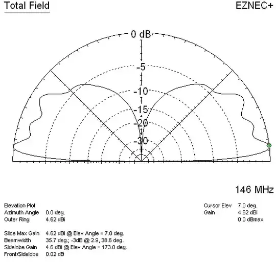

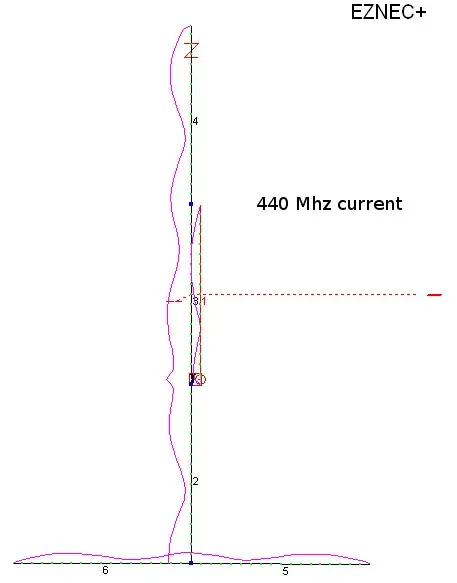

I spent some more time modeling this antenna in EZNEC+ 5.0.67. The latest results are interesting. Below the text here are 5 images showing:

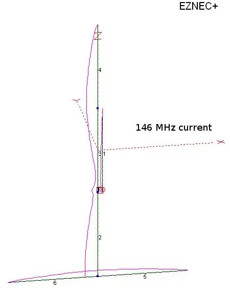

  1. The current lobes on all the elements at 146 MHz
  2. The elevation pattern and gain for 146 MHz

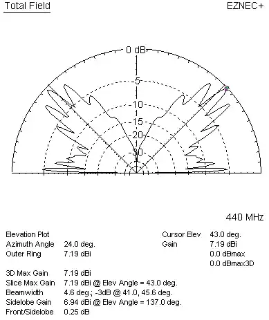

  3. The current lobes on all the elements at 440 MHz
  4. The elevation pattern and gain for 440 MHz

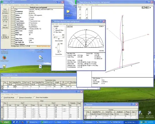

  5. A screenshot showing the parameters that I entered into EZNEC, so you can use other antenna modeling software.
Although I don't have the feedline and source placed where they really ought to be, I believe that the patterns, current distributions along the various elements, and gains (dBi) shown for each band are close enough.
Note the low gain at low angles when the antenna is operated on 440 MHz. The maximum gain occurs at 43 degrees! That's just too high if you're trying to access a distant station or repeater under minimal path conditions.
The pattern and gain on 2 meters is pretty good; however, a much smaller 2m antenna would do about as well.
As you'll notice, the distribution of the current lobes (shown in purple) along the elements do not seem quite right on either band. This is probably due to either:
  1. This model does not have the coax running from the feedpoint down through the middle of the lower section or
  2. The dimensions of the antenna are not quite optimized.
Also, if you run an auto SWR sweep in EZNEC, you'll find that the VSWR is rather high. Change the source and transmission line parameters, route the coax through a 'wire frame' representation of the lower pipe, and that ought to change.
