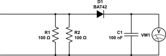

To check for loss, you can make a simple RF detector to measure the peak voltage:
schematic
simulate this circuit – Schematic created using CircuitLab
Use a Schottky diode for best sensitivity, though an ordinary silicon diode like 1N4148 may work well enough. Keep the leads between the resistors, diode, and capacitor as short as possible. The voltmeter can have long leads since it's measuring DC. Ordinary 1/4W resistors are fine as long as testing is limited to low-ish powers (<10W) and brief (a couple seconds) periods.

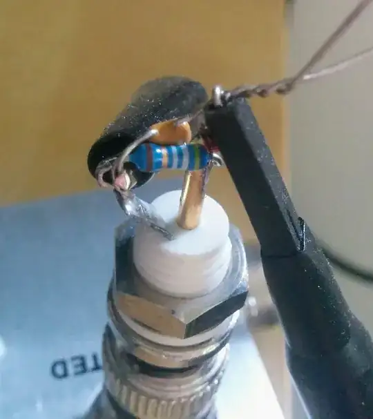

I build it into a BNC connector. This one worked fine at 440 MHz:
Measure the power directly from your antenna analyzer / signal generator / low power transmitter. Then put it on the end of the coax, and measure that. Power is proportional to the square of voltage.
$$ \text{loss (dB)} = 20 \log_{10} \left(V_\text{in} \over V_\text{out}\right) $$
If the cable passes visual inspection, SWR test, and loss test, it's fine to be reused. And you'll also know the loss, so you can decide if it's worth getting some better coax.
