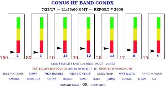

This image below is from K5BIZ's website (which has been offline for several months now). The network of receivers feeding data to it from K5BIZ's beacons is the most reliable indicator of real-time HF band conditions we've found. The majority of the time, the arrows on each band graph there have mostly been in the red areas of the the graphs for most of these bands like below, and they closely indicate what we hear on the bands. It wasn't always like this.
I know we are near the solar minimum, but it certainly seems that something else is at play. Many other hams concur. What could it be?
Typical poor band conditions

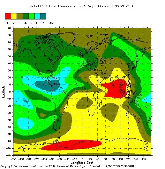

Bandconditions.com has been down. A good alternative is this site. Refresh to see current global ionospheric propagation conditions

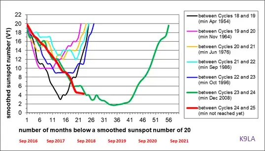

In an effort to find some hard data, I wrote to Dr Carl Luetzelschwab, K9LA. Carl responds:
"The main reason is because we've basically been under solar minimum conditions for two years - and it looks like it's going to continue. We were spoiled by [shorter - Ed.] solar minimum durations prior to the minimum between Cycle 23 and 24."
The graph Carl attached to his response summarizes the data:
Brian K1LI
  • 7,808
  • Do you know where Carl obtained this graph? I would be interested in seeing an up-to-date version. – Someone Nov 04 '22 at 20:22
It's pretty clear that we've reached the ~10.7-year solar cycle minimum in the midst of a low part of the ~87-year Gleissberg Cycle. See this explanation from Wikipedia.
Occam's Razor points toward this relatively simple (though unfortunate for us hams) scientific explanation rather than other explanations.
