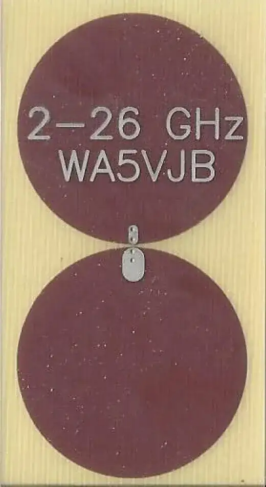

When I was investigating antenna geometries for 2.4 GHz, looking for extremely wideband antennas that wouldn't need tuning, I came across (article) a very simple wideband antenna. Picture two discs (pizza pans?) as elements of a dipole. One connected to the coax shield and the other connected to the center conductor; this is NOT the antenna I was simulating, but it is a similar one:
PCB antenna
In simulation using XfDTD it worked out quite well, and was very resistant to detuning by nearby metal surfaces. "nearby" of course being relative to wavelength.
At 2.4 GHz I was only looking for a fraction of the bandwidth you are, but I suspect you could experiment with this and have some fun.

  • Where's the connection between center conductor and disk? Does this maybe look like a mickey mouse, a bit? (my real question is: this sounds interesting, would you mind making a quick & dirty drawing, and upload it? Or a photo(I'd actually prefer the drawing) (maybe both)? (if you can't add images to your answer yet, just upload to imgur.com and add the link to your answer)) – Marcus Müller Jul 26 '17 at 19:31
  • Here's a link: https://turbofuture.com/misc/How-to-Build-Your-Own-Planar-Disk-Antenna – user103218 Jul 26 '17 at 21:32
    took the freedom to integrate one of the pictures from the article and a link to the article into your answer. Ha, WA5VJB is Kent :) he's known for his PCB antenna, and professional radio companies sell his antennas as accessories to their SDRs (though that afaik only applies to his logper, not to his vivaldi and dual-constant-curvature aperture (double-circle) antennas)! – Marcus Müller Jul 26 '17 at 21:42
    Nice :) this is really what I was expecting. The trick basically is that the "gap" between the two circular "dipole elements" allows for waves at a whole range of different wavelengths to "become free" from the conductor, whilst the circular shape at least partially restores matching to the feedline impedance :) This is pretty similar to how Vivaldi antennas work (of which you can see some examples in the article you've linked to, bottom image, the five similar antennas on the right of the photo, or [on his website](http://www.wa5vjb.com/products5.html)) – Marcus Müller Jul 26 '17 at 21:49
  • This is interesting. `In simulation using XfDTD it worked out quite well,` ... Do you have any data or charts you can share here? Also, since this is a balanced antenna, feeding it with anything but parallel line will cause the feedline to both radiate and pick up signals and noise. – Mike Waters Jul 26 '17 at 22:10
  • That's pretty cool, Markus. When I see really wide conductors I always think of increased bandwidth, but this takes it to a whole new level. – SDsolar Jul 26 '17 at 23:16
  • Is there any "cookbook" indication on the size of the discs and the space between them to get a specific band? I assume that this design would be also quite impractical at LF range where I would probably need a moon-sized disc (actually two) – Luca Jul 27 '17 at 09:55
  • @Luca yes – the article that is linked here doesn't mention it for some reason (it's actually pretty close to plagiarism) that the original article describing these antennas was also written by Kent [and is available online](http://www.wa5vjb.com/references/PlanarDiskAntennas.pdf). But yes, disk diameter is $\frac\lambda4$ of lowest frequency. – Marcus Müller Jul 27 '17 at 12:36
  • The design was proprietary, and all the info is back on the computer for the company I was working for. A balun might be better, but the simulation I was running was single ended feed, and essentially zero feedline length. YMMV Etc. At LF this would be a highly impractical antenna! :) I would consider it for probably 100 MHz and up though. – user103218 Jul 27 '17 at 14:57
