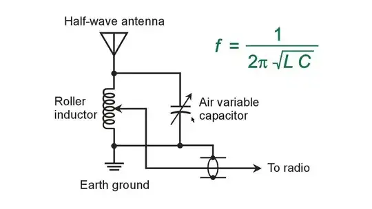

The first is presented, among others, in a nice video by Stan Gibilisco but applies to wire antennas, whereas I would like to have a loop or dipole antenna.
second

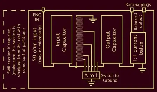

The second is presented here although is designed for transmission and not reception.
As far as my understanding goes, the one from Gibilisco is essentially a tank circuit defined by L and C that can be tuned to a specific resonant frequency and the inductor is used for impedance matching with the radio.
The other is a series LC circuit (T-network) but I don't understand why a second capacitor is needed. There is a sort of explanation on the link but I can't wrap my head around it.

4. Related to the second design (the VK5AJL design), why there are two capacitors? Wouldn't a L or tank circuit also work?

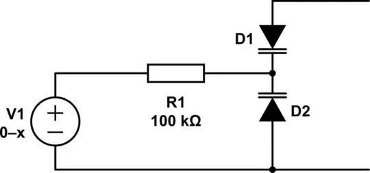

Bonus: There's electronically variable capacitors! They're called varactors or varicaps (or just variable capacitance diode), and they're a very mature (read: old & well-tested and used everywhere) and thus, cheap, method of tuning receivers.
You probably have heard of what a diode does in reverse bias: it doesn't conduct. Of course, that means that there's then two conductive pieces isolated from each other. Since the blocking layer is relatively thin in a diode, these work as a capacitor. By changing the voltage bias, you can make that layer thinner or thicker, and thus, you can change the capacity of that "accidental" capacitor with a DC voltage. Awesome!
When you design a diode for exactly that purpose, you can make sure that this effect is very well-controlled. These diodes then are sold as varicaps/varactors.
http://www.radio-electronics.com/info/data/semicond/varactor-varicap-diodes/circuits.php has a few very minimal circuits illustrating the usage of varicaps. The back-to-back configuration is what you usually encounter:
schematic
simulate this circuit – Schematic created using CircuitLab

L scales with size and length of the coil, and C is usually made adjustable. Thus, in the place where in the classical small-loop antenna you'd find the manually adjustable capacitor, you could place the adjustable capacity circuit I mentioned above. Battery operation is a good idea here, for both noise and potential separation reasons; that doesn't mean you couldn't also use a bog-normal 230 V -> 12 V transformer, rectify the resulting voltage, smoothen the hell out of that voltage and then add a simple voltage divider or adjustable voltage regulator to drive the varicaps, as long as everything float relative to your receiver – you'll be the ground of your voltage source to one end of your receiver coil, and you don't want that to be "accidentally" connected to real ground.
Regarding practical varicaps that you can buy:
well, look in the places where you'd buy electronic components. I've got good experiences with Mouser, shipping was 5–6€, I think. The BB 640 series (datasheet) looks like a good match for you – nearly 20 times the maximum capacity than minimum capacity means that you can change the resonant frequency over a range of $\sqrt{20}$ (see above formula for resonant frequency). If the maximum achievable capacity is too low for you, just put multiple in parallel.
