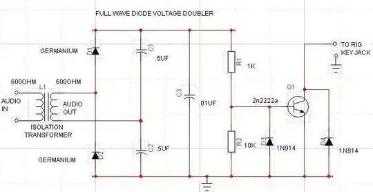

It's somewhat common to find a schematic that calls for a germanium diode in amateur radio contexts. For example:
This is a QSK circuit from the Fldigi manual.

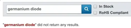

And yet, purchasing a germanium diode is a relatively difficult task. For example, Mouser's offerings from 600 manufacturers doesn't seem to include a germanium diode:
(Although, they do have a few germanium BJTs)

In this particular application, silicon diodes will almost certainly work just fine. Maybe you will have to increase the output level of the sond card to compensate for the higher forward voltage.
Germanium diodes are often found in older schematics of RF measurement instruments. These designs rely on the characteristics of germanium diodes and you have to consider the specific application to decide if and how you can substitute a different diode.
