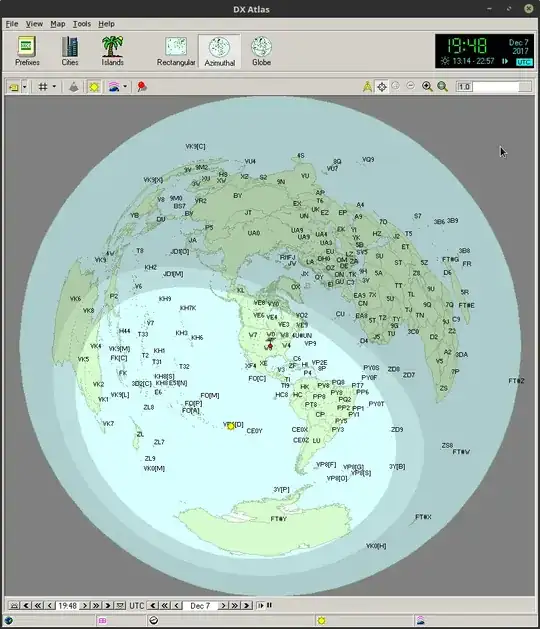

There is also gray-line propagation, where signals can travel around the world at the circular dusk/dawn annulus. In that region, it is neither totally dark nor totally light.
Long-Path QSOs are usually made following the path of this grayline (shown below). However, QSOs via the shortest path is more common than long-path (which has greater attenuation). Hams have worked DX for over 100 years using this...
  • In the period before, during, and after Sunset
  • In the period before, during, and after Sunrise
It is not unusual to hear the same station with an echo on it. That's usually caused by receiving the short path signal first, followed by the delayed long-path signal.
Grayline region
