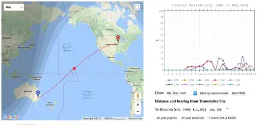

Very unlikely. 100W SSB over 9,000 miles is already a challenging path, but these antennas are very inefficient which will make it nearly impossible. Let's simulate with VOACAP.
This is 100 W SSB, with 0 dBi antennas at each end, and a quiet noise floor. If the receiver is near a city, man-made noise will make the situation much worse.
Your best chance is on 20 meters, at 2100 UTC, where the circuit reliability is 23%.
0dBi is a very generous estimate of that antenna's gain. Unfortunately VOACAP doesn't offer a worse antenna to simulate.

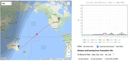

However, turning the power down to 10 W is a 10 dB reduction. If we are considering each end of the link to have one of these loop antennas, that makes this case equivalent to a -5 dBi antenna.
Now at best, circuit reliability is 8%.

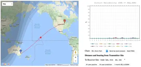

I think -5 dBi is too optimistic for this antenna. Turning down the power to 1 W is equivalent to a -10 dBi antenna on each end:
Now your best shot is down to 2%.
