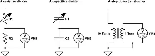

Sampling the Voltage
SWR meters use one of three different methods to sample the complex voltage at the point of insertion.
schematic
simulate this circuit – Schematic created using CircuitLab
In each case, the voltage sampling circuit steps down the higher voltage that is present on the transmission line at the point of insertion to a more manageable lower voltage for the SWR meter circuit. In the case of the resistive and capacitive divider circuits, the upper element is typically adjustable to allow the SWR meter to be calibrated (more about this later).
The voltage present on the transmission line at the point of sampling is the complex sum of all of the forward voltages plus the sum of any reflected voltages resulting from a mismatched load and source. This can be expressed as:
$$V_\text{line}=V_f+V_r \tag 1$$
where Vf is the complex forward voltage and Vr is the complex reflected voltage at the point of sampling.
The sampled voltage from any of the above circuits can then be expressed as:
$$V_1=(V_f+V_r)*k_1 \tag 2$$
where k1 is the scaling constant as determined by the voltage sampling circuit design.

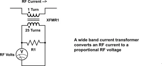

Sampling the Current
Nearly every SWR meter uses the same technique to sample the complex current that is present on the transmission line at the point of insertion. The technique involves a circuit that at first glance looks like a step-up voltage transformer with a load resistor on the secondary, but it is actually a special configuration known as a wide band current transformer.
A wide band current transformer converts the RF current that is passing through its primary side, to a proportional RF voltage on the secondary side. The conversion takes place by placing a load resistor (sometimes called the burden) on the secondary side. The load resistor must be much smaller than the characteristic impedance of the secondary side of the transformer for this current to voltage conversion to be proportional.
schematic
The transformer is typically a toroid device with the center conductor of the transmission line passing through the hole of the toroid to form a 1 turn primary winding with the secondary winding wrapped multiple times through the toroid form.
The complex current that is present on the transmission line at the point of sampling is the difference between the forward current and the reflected current:
$$I_\text{line}=I_f-I_r \tag 3$$
where If is the complex forward current and Ir is the complex reflected current.
The complex voltage resulting from the sampled current using a wide band current transformer can then be expressed as:
$$V_2=(I_f-I_r)*k_2 \tag 4$$
where k2 is the transformation factor, in volts/amp, as determined by the wide band current transformer circuit design.

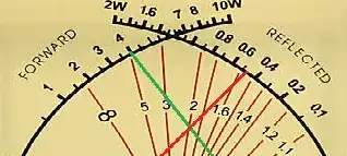

Dual Needle SWR Meter
The conversion of forward power and reflected power to SWR is given as:
$$SWR=\frac{1+\sqrt{\frac{P_r}{P_f}}}{1-\sqrt{\frac{P_r}{P_f}}} \tag {10}$$
Or alternatively the conversion of Vf and Vr to SWR is given as:
$$SWR=\frac{1+(V_r/V_f)}{1-(V_r/V_f)} \tag {11}$$
The meter face pictured above shows the intersection of the two needles on the 2:1 SWR line which corresponds to equation 10 for the powers shown. The SWR meter designer simply plots a number of SWR values on the meter corresponding to the intersection of the forward and reflected powers.
