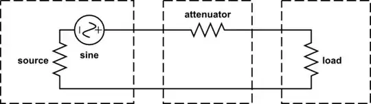

This is because only the loss part of the transmission line contributes its thermal noise. Think of it this way:
schematic
simulate this circuit – Schematic created using CircuitLab
An attenuator is not typically built as a single series resistor, but from a noise equivalence perspective we can consider it so, with Rattenuator being some value required to achieve the necessary attenuation, which will also depend on the source and load impedances. As the transmission line becomes lossless, Rattenuator approaches zero, and thus so too does the noise.
