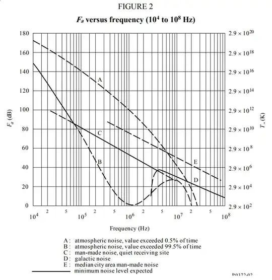

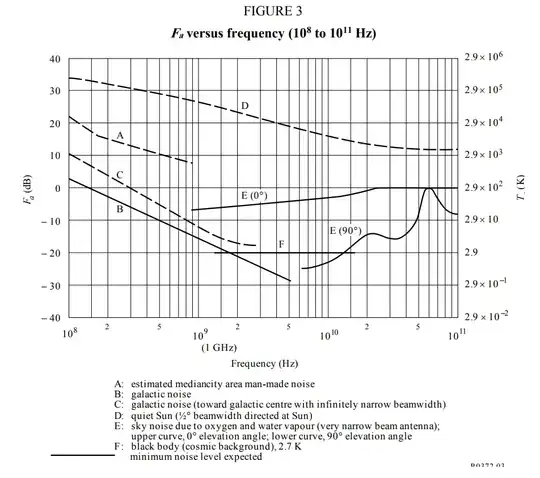

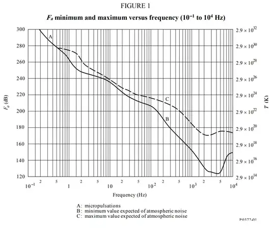

ITU-R P.372-14 provides some excellent data on environmental noise temperatures. The document is worth a read, but here are a few relevant figures from it:
figure 1
figure 2
figure 3
Each figure covers a different frequency range, noise temperature on the right axes, and equivalent noise figure on the left. The noise temperature doesn't come anywhere near 290 K within HF. At microwave frequencies 290 K might be realistic, provided no man-made noise and an antenna directional enough to avoid the sun.

Let's say we're using this at 400 MHz in a city. Line A (man-made noise) in figure 3 puts external noise temperature around 3000 K. So by equation 3:
$$ { \text{SNR}_\text{in} \over \text{SNR}_\text{out} } = 1 + {18174\:\mathrm K \over 3000\:\mathrm K} = 7 = 8.49\:\mathrm{dB} $$
Under these conditions, this terrible station will make the SNR 8.49 dB worse. Bad, but not as bad as the 18 dB noise figure would suggest.
Now what if this is a 7 MHz station is a very quiet location? Figure 2 is hard to read precisely since it spans 18 orders of magnitude, but line D (galactic noise) at 7 MHz is at least 300,000 K.
$$ { \text{SNR}_\text{in} \over \text{SNR}_\text{out} } = 1 + {18174\:\mathrm K \over 300000\:\mathrm K} = 1.06 = 0.256\:\mathrm{dB} $$
Attempts to reduce noise with an LNA, better receiver, etc. are futile. The SNR must be improved at the source, for example by increasing antenna directivity.
