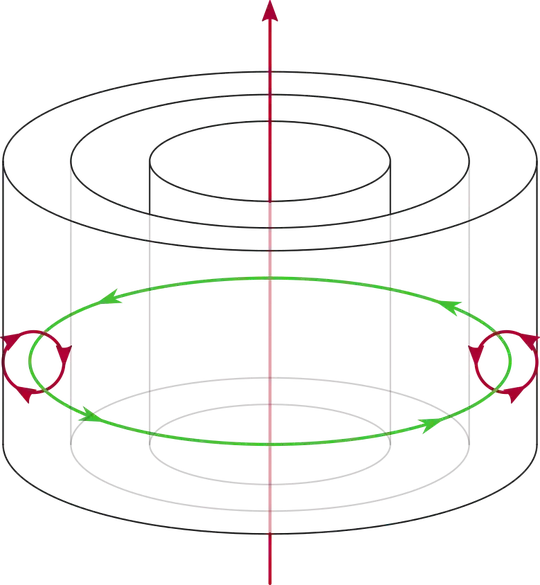

Imagine a primary current flowing through a solid, cylindrical conductor. Let's pretend it's a uniform current through the entire cylinder.
The primary current (straight red line) has an associated magnetic field (green circle). The right-hand rule determines the direction the magnetic field curls.

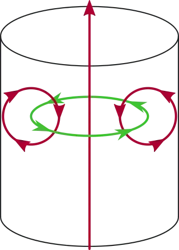

Because this is an AC current, that magnetic field is constantly changing. This in turn induces eddy currents (red circles) by Faraday's law of induction. The left-hand rule determines which way they go.
We can consider the net current we observe as the superposition of the primary and eddy currents. In the center of the conductor the eddy currents oppose and cancel the primary current, meaning very little net current in the center of the conductor. On the outside of the conductor the eddy and primary currents point in the same direction, so this is where most of the current is found.
Within the conductor, the eddy currents cancel the magnetic field. But the conductor is still surrounded by a magnetic field in space around it. And surrounding the space around the center conductor is the shield, which will intercept that magnetic field and thus have eddy currents induced within it.
Because we're talking about a piece of coax with only differential-mode current, we know there's an equal but opposite current in the shield, going down. Look now at the orientation of the eddy currents and the effect they would have on a downward current in the shield: current on the inside of the shield is reinforced, whereas current on the outside of the shield is cancelled.
This is why differential mode current is on the inside of the shield. It's not because it's "trapped inside" by skin effect. Rather, it doesn't want to get out. Eddy currents give rise to skin effect which describes a single conductor. When there are two conductors the interaction between them must be considered.
