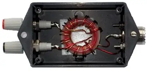

Design 3: Parallel wires wrapped around a core (see picture below)
This is the one that doesn't make sense to me. The windings would block common-mode currents, sure. So I suppose your antenna would be fed a balanced signal. But the coax ends before the windings. Wouldn't that mean RF can still flow to the outside of the shield?
a howebrew balun
(From http://www.m0pzt.com/baluns/)

I'll explain the operation of that balun very briefly: for the differential mode (which by definition has equal but opposite currents on each conductor), each conductor induces an equal but opposite magnetic flux in the core. These magnetic fluxes cancel, and so the differential mode sees no inductance: it's as if the core and the windings aren't there.
Meanwhile the common mode interacts with the core like an ordinary, single wire, and sees a large inductance. This high inductance makes the common mode on the coax a high impedance (hopefully) relative to a lower impedance path like radials, the other arm of a dipole, or some other deliberate counterpoise.
But I think your question isn't really about how it works. Rather, it's a mental hangup right here:
With coax in particular, due to skin effect, the inside and outside of the shield act as different conductors.
So, I bet you are thinking that with the balun pictured in your question, the end of the coax is "exposed", and that means common mode current can "get in", causing problems. You may be thinking once the common-mode current is inside it's stuck there, isolated from the outside by skin effect. With coiled coax or coax through beads the integrity of the coax is maintained, so nothing can "get in".

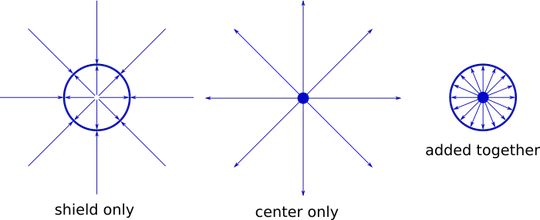

Let's consider a cross-section of coax with equal but opposite charges on the center and shield, and the associated electric fields:
Added together, there's no field at points outside the shield. That the charges are on the inside of the shield is really not the primary thing to be thinking about, because if the charges on the inner conductor went away, the charges on the shield would migrate to the outside.
And so getting back to your question about the balun, you don't need to be concerned so much with the distinction between the inside and the outside of the shield. Rather, think about maintaining equal and opposite currents and charges on the shield and center. If you do that, the fields will cancel like this, and the coax won't radiate.

Short answer: No, and in fact you'll often get more bang for your buck by avoiding coaxial baluns.
The description of the balun's purpose in an antenna system you quote is an oft repeated bit of "common wisdom" in ham radio, but it is such an over-simplification that it is at best drastically misleading and at worst, just plain wrong.
The purpose of a balun in an antenna system is to suppress common mode current. That's it. You can (and should) use them on balanced line, even when feeding it with a balanced tuner. You can (and should) use them on balanced, resonant antennas like dipoles that are fed with unbalanced feedline, even if the SWR is perfect. You can (and should) use them between an unbalanced vertical antenna and a coaxial feedline. (A side note: Virtually every ham radio antenna system should have some form of common mode suppression mechanism installed, regardless of antenna or feedline type).

So the problem is not that there is current on the outside of the coax shield, the problem is that the current on the outside of the coax shield is unopposed. If we were to solder two wires to a bit of coax, one to the shield and one to the center conductor, then wrap those two wires around a ferrite toroid as your image shows, the current on the two wires interact with the toroid about equally. If the two wires were carrying unequal currents, they wouldn't cancel exactly, and a magnetic field would be induced in the toroid. By selecting materials that are very lossy at the frequency of interest, the balun can be used to dissipate only the portion of the current that is unopposed. If 10 watts were flowing on the center conductor, but only 8 watts were flowing on the shield in total, a field equivalent to 2 watts would be induced on the toroid and turned in to heat. At that point the current on the two wires is once again balanced, and no current will appear on the coax shield, because there is no unopposed component remaining.
Imbalance in antenna systems is virtually universal. They are designed to radiate, which means they must, by their nature, couple heavily to their nearby environment. This inevitably means that the antenna system will be prone to picking up local common mode noise, as well as generating common mode current due to asymmetry in the antenna system. A balun is a way to ensure that the current on the two conductors is equal and opposite, nothing more or less.
