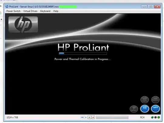

I have a new HP ProLiant DL360 G7 system that is exhibiting a difficult-to-reproduce issue. The server randomly hangs at the "Power and Thermal Calibration in Progress..." screen during the POST process. This typically follows a warm-boot/reboot from the installed operating system.
The system stalls indefinitely at this point. Issuing a reset or cold-start via the ILO 3 power controls makes the system boot normally without incident.
