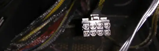

Here is a picture of the pins.

  • I presume you powered it on. Did the PSU just shut down immediately or keep going? Also could you post a picture of the end of the EPS cable, I'm quite curious to see how it could have gone in the socket. – Tom Carpenter Nov 14 '15 at 23:02
  • The PSU didn't seem to power on, no fans or anything like that spun up. Also I will upload a picture now – chiloutus Nov 14 '15 at 23:15
  • It seems as you pushed the connector in, it stripped the corners of the square pins (not very good plastic!). If the PSU didn't power on, it means it was clever enough to detect that you had basically shorted 12V to GND and not turn on (the 12V on the EPS connector would short out with the GND on the PCIe 6-pin connector and vice versa). The card is probably fine as it will never have seen any voltage. – Tom Carpenter Nov 14 '15 at 23:20

Really this should not have been possible as the PCIe 8-pin connector was designed to have a completely different arrangement of pin shapes than the existing EPS12V connector. These are shown in the image below (notice the difference in bevelling on the corners):
Locating Pins (Image from here)
It appears from the picture you posted that the cable that when you pushed it in, the corners of the square pins got scraped away allowing insertion - the moral is don't force connectors in (I'm not trying to be condescending, but it's worth keeping in mind).
