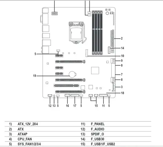

  • Motherboard power pin are universal. There are 24 pins and 8 pins what is required depends on the capability of the hardware but the pins are universal. – Ramhound Jul 08 '14 at 10:30
A PSU for your computer must fit your mainboard. According to the documentation on your MB you have to connect this ATX_12V connector. Otherwise the computer will not start.

  • Yes I understand that but that's not my issue. The cable you linked there has square corners on the top row and two square pins holes in the bottom row. My PSU seems to have one of the square pin on one corner and one square pin in the row above. The rest are rounded. – Lucas Jul 08 '14 at 10:29
  • @Lucas Sounds like you're looking at the wrong plug. There are 2 different plugs that have 8 pins. The EPS12V plug - which plugs into the motherboard, and the the PCI-E 8-pin Power plug which plugs into a power hungry graphics card. – Lawrence Jul 08 '14 at 10:32
  • Hmm perhaps I should check my old mobo and see whather the port matches up to the port I'm trying to plug it in to. – Lucas Jul 08 '14 at 10:36
  • @Lucas - Just check the layout of your motherboard. The documentation for your motherboard is contained within the answer. – Ramhound Jul 08 '14 at 10:48
  • Yeah I will, I definitely was trying to plug what I thought was the EPS12V in to the port shown but maybe the port on my old motherboard was not what I thought it was. – Lucas Jul 08 '14 at 10:54
  • So it turned out I wasn't putting the pin in the right way round... – Lucas Jul 09 '14 at 12:40
