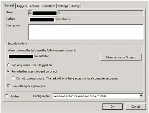

  • 1. General tab, ensure that the below options are select/checked or unchecked just as shown in Print Screen A
    • Uncheck Run only when user is logged on
    • Check Run whether user is logged on or not
    • Check Run with the highest privileges

  • 3. Actions tab, click Edit, and enure that the Start in (optional) is set just as shown in the below example (DO NOT put double quote marks around it) for the full path pointing where the batch script is located WITHOUT a final backslash "\" Print Screen C
Security Considerations
  • Once you press OK (2. above) it should prompt you for the credential to run this as, and that credential is what will need access to EXECUTE the batch file where it exist, and it will also need access to do whatever the batch file is running that you scripted out.
  • It may be best to setup a static service/proxy user account for this process and then use its credentials to run the process. You'd need to ensure its password is strong and it set to never expire—and it needs access to EXECUTE the batch and run whatever the batch scripted process is running and any commands and resources, ect. it utilizes as well.
  • It seems the option Run whether user is logged on or not you MUST check the option Run with highest privileges for it to actually run as expected from the Task Scheduler.
