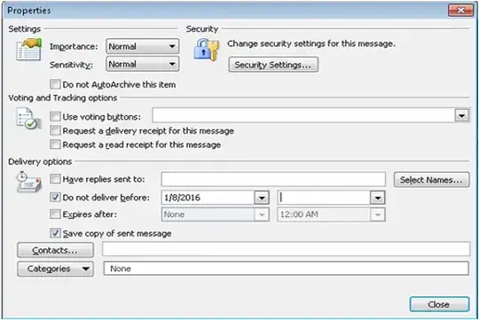

Use Outlook Delay or Schedule Sending Messages
The second way is with Outlook (2010 and 2013) using the Delay or schedule sending messages feature that is a little less specific on the time scheduling part (not by the second either).
When you tell Outlook not send before a certain time on a certain date, it'll send as soon as Outlook's outbox emails try to send queue items out when it's that time or later when it's triggered.
I have seen email sent via this method keep the date and time stamp of the actually time you sent these options and press Send rather than the time you told it to not run before. When you press Send to send it out, it just sits in an Outlook outbox queue until that time but not before.
Outlook 2013
Outlook 2013
Outlook 2010
Outlook 2010
