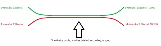

An Ethernet splitter can be thought of a type of device that isn't a hub or a switch. It is a rather simple device that actually does nothing but connect two pairs of 2 Ethernet cables to a single Ethernet cable. If you don't trust Ethernet splitters then you can actually build a cable that does the exact same thing.
A splitter works by taking two physical Ethernet ports and sending both connections (which must be limited to using 100mbps speeds) though a single cable. A splitter doesn't connect both ports together in any way. It keeps both ports isolated unlike hubs and switches.
Here is a diagram to show you how a typical Ethernet splitter system works. Ethernet splitter wiring diagram
Basically, 100Mbps Ethernet only uses 2 out of the 4 pairs in a standard Ethernet cable unlike 1Gbps Ethernet which uses all 4 pairs. In 100Mbps Ethernet, 2 pairs simply get unused. In theory, if you were working with 100Mbps Ethernet, you could use the 2 unused pairs for almost anything. PoE is one way you can make use of the two unused pairs (PoE only works with 100Mbps connections for this very reason). Splitters are just another way of making use of the two unused pairs since you can fit entirely another 100Mbps connection since the connection requires only 2 pairs.
Unfortunately, there are several downsides with using splitters:
  • You'll be limited to 100Mbps speeds even if you connect it to hardware capable of 1Gbps speeds. Each connection lacks the necessary pairs to do 1Gbps speeds. Hardware that does 1Gbps speeds will see that 2 pairs are missing and auto-negotiate a speed of 100Mbps.
  • You still need 2 free ports on your existing switch/router. Switches/routers only provide one connection per port. Trying to use a splitter to turn one connection into two won't work since that's the job of switches/hubs which clearly, a splitter is not either of. If you attempt to use this two turn one connection into two, I see two possible scenarios: Only one device will receive a connection, or, the port on the switch/router will fail to work properly with both devices connected.
  • Any cable you connect to the splitter will count towards your total cable length. However, since a splitter has 2 physical connections, you have two cable lengths instead of just one. Theoretically, splitters don't amplify signals so your maximum cable length will not be extended.
Now to answer your question: It will work but only under certain conditions. If you need more than 100Mbps speeds then either run another cat 5e cable to your room or buy another switch. If this is not possible then you'll have to deal with 100Mbps speeds. Also, if you have only one spare port on your router/switch, this is not going to work for you.
