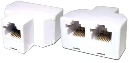

An Ethernet splitter takes advantage of the fact that 10MBit and 100Mbit Ethernet only use 4 wires, even though the cable (almost certainly) contains 8 wires. The splitter consists of two pieces (see picture): one is connected to each end of the existing cable, providing the appearance of two ports at each end. Each link has 4 dedicated wires, so there is no risk of packet collisions. Gigabit Ethernet does require all 8 wires, so 100MBit (full duplex) is the limit through a splitter; a Gigabit switch would be required to increase the bandwidth. Also, if your router only has one Ethernet port, then using a splitter is not an option.

Referring to your other question, I've listed the main pros and cons of each option:
Ethernet splitter
  • + Ought to be cheapest
  • + Passive; doesn't require a power supply
  • - Limited to providing one extra port, at 100MBit/s
  • - Destination switch/router must have two free Ethernet ports
100MBit/s switch
  • + Potential for many extra Ethernet ports
  • - Requires some set-up
  • - Requires a power supply (unless powered by PoE)
Gigabit switch
  • + Higher bandwidth
  • - Most expensive
  • - Requires the rest of the network (LAN) to support Gigabit to benefit
Hub
  • + Relatively cheap, but...
  • - ...not significantly cheaper than switches
  • - Very poor performance, especially as network load increases (due to collisions)
  • -\+ May or may not require a power supply

  • Do you actually need a splitter on both ends? Doesn't the router detect that two (separate) devices are used, on wires 1-4 and 5-8? – M.Mimpen Mar 27 '17 at 14:34
    Yes, a splitter must be used at both ends. Using the wires in that way isn't part of the Ethernet standard. – sblair Mar 28 '17 at 22:20
