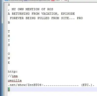

It’s like everything got shifted to the right, although this does not quite explain the situation either, because some lines are beginning the way they should be. Anyway, an example, as far as the left margin:
**EXAMPLE OF APPEARANCE**

  • Can you enable `View->Show Symbol->Show End of Line` and link an image in the comments? – Mateen Ulhaq Feb 25 '16 at 05:20
  • For the future, put your important documents under version control or create backups. You can configure Notepad++ to autosave a backup for you every hour. – Mateen Ulhaq Feb 25 '16 at 05:20
  • Dear Mateen, thank you so much for lending me a hand. The image you asked for is here: http://i.stack.imgur.com/e6ZAS.jpg ... I have tried to get the Autosave feature to run, but failed to make it work; "version control" is something I am ignorant of. I do have a backup of the document, but it is from ten days ago and I have made so many changes since... – Jeff Feb 25 '16 at 09:19

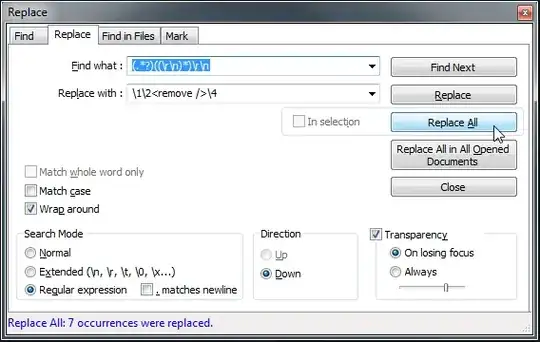

Looks like you have duplicate CRLFs. Try running a Replace (Ctrl+H) with Search mode set to Regular Expressions and replacing
(.*?)((\r\n)*)\r\n
with
\1\2<remove />\4
Run another Replace:
<remove />
with
(empty)
Mateen Ulhaq

  • I updated my answer with images; make sure to copy exactly what is written (\ vs /). I'm not too sure about Autosave (I don't use Notepad++). – Mateen Ulhaq Feb 25 '16 at 22:36
  • You don't use Notepad++ and you know all of these ins and outs?? I wish I could take a little piece of you and have you with me on all walks of life... think of how much more problem-free I would be. It was so considerate of you to go through the trouble of preparing those images for me, thank you. Your instructions were clear, however, and there was little room for error on my end... I merely copied and pasted your kindly-provided lines. But I went through the process again, and once again I got the "0 occurrences" message at the bottom of the Replace box. Please allow me to thank you again. – Jeff Feb 26 '16 at 04:55
  • @Jeff My apologies; I should have tested the regex a bit better. It should run now. – Mateen Ulhaq Feb 26 '16 at 17:17
