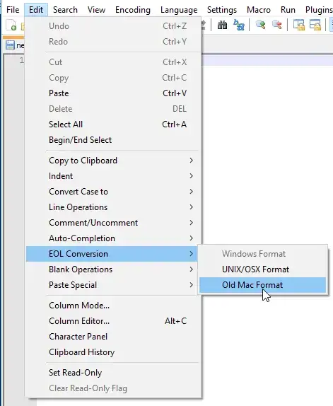

In the Notepad++ menubar click EditEOL ConversionOld Mac format to format for entire files.
Image of How to Do this.

    I think you mean 'EOL Conversion', but that was exactly what I was looking for! Thanks! – Gary Jun 01 '16 at 21:08
  • I find this to be the more consistent way over the find/replace method. There is some weird behavior of notepad++ that if the first line of the file is \r\n, the find will not recognize it as it does all the other \r\n in the document. EOL Conversion does not face this problem – demongolem Mar 17 '17 at 14:59
  • Official Notepad++ documentation that pertains to line ending: http://docs.notepad-plus-plus.org/index.php/Lines_And_Blocks – Julian Oct 24 '18 at 08:47
  • German: Bearbeiten -> Format Zeilenende -> UNIX (LF) – PeterCo Jul 11 '19 at 06:47

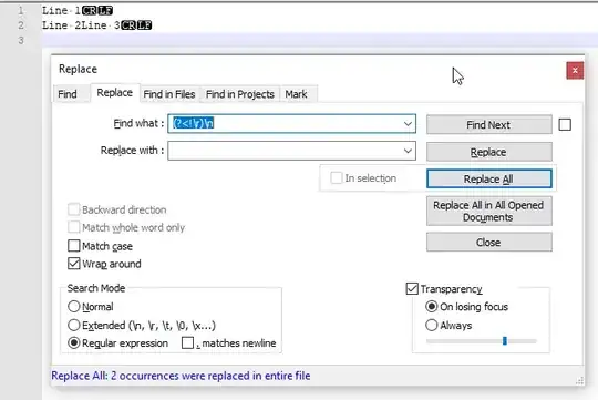

Negative lookbehind allows you to find and replace just the LF that are not preceded by a CR:
(?<!\r)\n
Before:
before
After:
after
