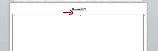

I need to remove the mysterious space marked in this screenshot:
Photo for Space between line and table
I searched before and found some answers in this previous thread: How to remove extra space between line of text and table but unfortunately it didn't help in my case. All line spacing after the line is set to 0 and Single as well as all the line spacing in the table itself.
It's quite a mystery!
Thanks in advance.

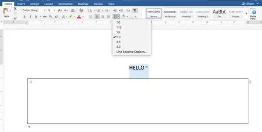

Check line spacing options in Word:
And try selecting line options after selecting text.
Check the results before and after:
BEFORE: Before
AFTER: After
