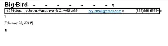

In Word 2013, I want to be able to have the table flush with the line of text above it. That is to say, I don't want the extra line break. I indicated in red the area I want removed. How can I do this?
UPDATE: @Shevek there still is a bit of a space still space
@Milena Petrovic I did so and you can see it in the screen shot.

This is probably caused by Spacing on the text
Select the line of text, right click and select Paragraph
Set Spacing -> After to 0 pt
Set Spacing -> Line Spacing to Single

To be sure why there is a gap, turn on the formatting symbols first
  1. Click the Show/Hide in the menu
  2. If there is a line, make sure it's deleted
3.On the Home tab, expand the Paragraph section (bottom right arrow)
4. Set both Before and After values in the Spacing section to 0, and set the Line spacing to Single, as Shevek suggested
