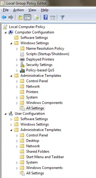

  • @Mr.Raspberry I used group policy settings but when I put 1 or 2 as max monitors (on RDCed computer), it only shows on single monitor, but when I change that to 3, then RDC uses all 3 monitors. Group policy does apply on my computer (not RDC) for some reason. – Farhan Oct 10 '17 at 18:54
