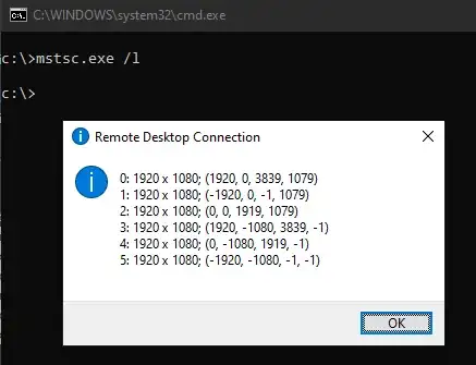

To get a list of target monitors, you can use
mstsc.exe /l
to list current monitorIDs for use in your RDP file, results looking similar to: enter image description here
Caveats:
  1. You must select monitors that share a screen edge.
  2. Some users report that monitorIDs change between reboots.
