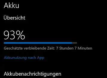

I am examining a new Surface Book 2 and missing the battery time remaining estimation. On a Surface Pro 4 it behaves as expected and I try to check the differences.
If you google it, there are many opinions. Many user say it is missing since 1709 Update.
Obviously there are some (HP) Laptops that can bring back the information as an BIOS/UEFI option, so it seems to be an ACPI call? But the Book2 as well as SP4 have no settings in this scope.
Also the connected standby feature being disabled may bring back some behaviour.
I am currently checking this reg hive: Computer\HKEY_LOCAL_MACHINE\SYSTEM\CurrentControlSet\Control\Power
And I am wondering about the meaning of the entries.
e.g. UserBatteryDischargeEstimator which is nearly impossible to find with google and it exists only on the SP4.
Are there any Surface Book 2 out there that show that estimated time, so a UEFI issue could be ruled out? Is it OS or Hardware related?
Any ideas or docs that may help with that issue? 3rd party apps and disabling modern/connected standby are not an option, as I want to understand the root cause why it works with the SPro4 but not with SBook2

As strongly suspected and concluded in the Q and comments:
after adding:
[HKEY_LOCAL_MACHINE\SYSTEM\CurrentControlSet\Control\Power]
"EnergyEstimationDisabled"=dword:00000000
and optionally deleting the keys
EnergyEstimationEnabled
the missing remaining time estimation is finally back after a reboot!

Here's what I had to do:
1) Delete [HKEY_LOCAL_MACHINE\SYSTEM\CurrentControlSet\Control\Power] "UserBatteryDischargeEstimator"=dword:ffffffff
2) Delete and then re-add "EnergyEstimationDisabled"=dword:00000000
My registry had the EnergyEstimationDisabled set to 0 and when I deleted UserBatteryDischargeEstimator - the timer did not appear. So I deleted and then re-added the EnergyEstimationDisabled key and it works fine now.

On a MS Surface Pro 2017 i7 7660 16gb Ram 528gb HD I had to;
Delete
[HKEY_LOCAL_MACHINE\SYSTEM\CurrentControlSet\Control\Power] "EnergyEstimationEnabled"=dword:00000001
Then Add
