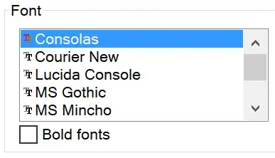

How to add new fonts to your Powershell (Or CMD) Console settings?
First thing to know, is that, unfortunately (!):
Only fonts fulfilling certain criteria can be installed into the console!
(See: here, here and here.)
The Font Criteria + Explanation
(The current status of this is unknown.)
For Font to be supported in Console they have to:
- The font must be a fixed-pitch font.
- The font cannot be an italic font.
- If it is a TrueType font, it must be
FF_MODERN.
- If it is not a TrueType font, it must contain the
OEM_CHARSET.
- The font cannot have a negative
A or C space.
What does all that mean?

However, you will not see the new font items, until:
- the registry has been reloaded into memory, so the only way is to either:
- reboot the computer or
- restart
Windows Explorer.
- Restart your Powershell Console
