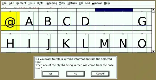

First, you want to open the font with the missing glyphs and select Element -> Merge Fonts. In this example, the glyphs for E and F are the ones missing.
Select the font from which you want to pull glyphs. You will be asked whether you want to keep the existing kerning; you most likely want to select No here, but if you get strange results close fontforge and try again with Yes.

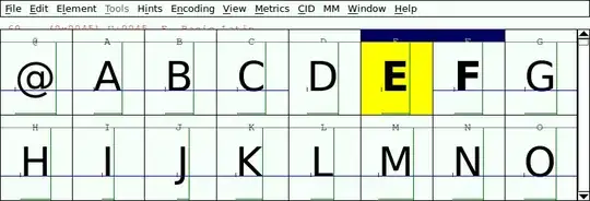

The missing glyphs should be added in a few moments:
Finally, do File -> Generate Fonts and export your font to a desired location.
