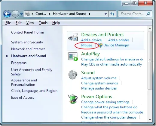

Little HOWTO about waking up with mouse:
Go to: Start -> Control Panel -> Mouse.
alt text
In the Mouse Properties window, click on the Hardware tab and select your mouse from the list of devices. Normally, there will only be one mouse listed here but that will depend on the hardware you have connected to your computer. When you have selected your mouse from the list, click the Properties button.

In the window that opens, click the Power Management tab and check the option titled Allow This Device to Wake The Computer. Click the OK button on this window and click the OK button on the Mouse Properties windows that is still open. From now on, you can wake up Windows 7 from sleep mode by clicking a mouse button or moving the mouse around.
