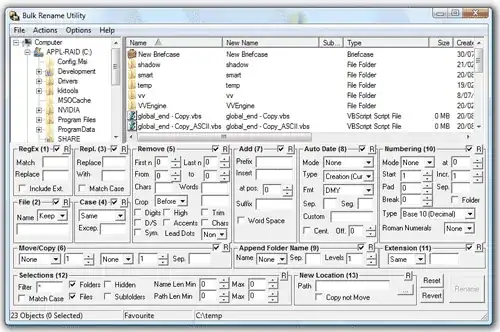

The absolute best tool I have found for this is Bulk Rename Utility.
Bulk Rename Utility
It isn't a command line tool, but they do have a command line version if you really want to use it that way.
I've used the GUI version a lot, and it is very powerful, very fast and extremely easy to use.
Oh, and it is FREE for personal use.

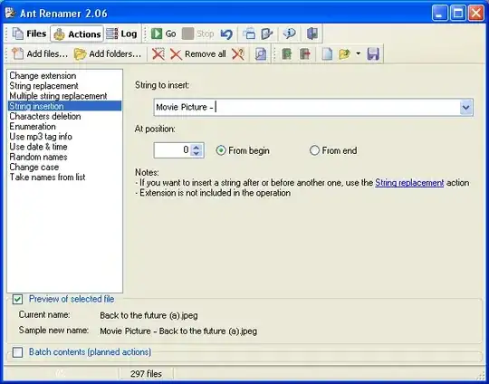

AntRenamer makes it quite easy to define a pattern of renaming; there are plenty of ones already prepared (and it gives a preview of the actions):
AntRenamer
Free for personal and commercial use.

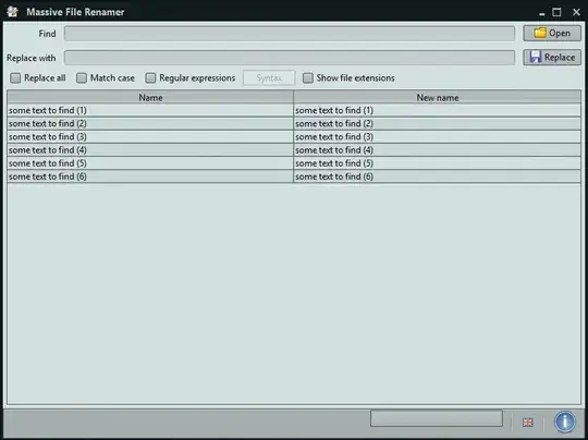

Another option: Massive File Renamer
It allows to easily rename multiple files and file extensions. It's very fast and simple!
For advanced users and developers, it is possible to use regular expressions.
See it in action:

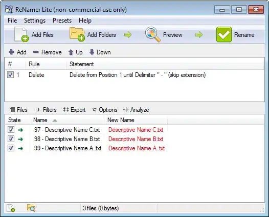

The tool that I've been satisfied with is ReNamer. It supports also the saving of renaming rules, which has been useful to me, as I many times do the same renamings.
Below is an example of how to delete text before the first dash, but there are loads of other rules you can define.

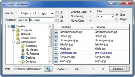

For advanced users and developers, I would suggest RegexRenamer.
RegexRenamer screenshot
Pro's:
  • Very simple UI;
  • Regular expressions that the developers familiar with;
  • GPLv2;
Con's:
  • It's not a command line! :)

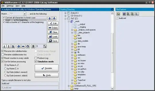

I like Cylog’s WildRename. It is powerful, yet easy to use, and has a lot of features:
  1. fast
  2. string manipulation
  3. counters
  4. wildcards
  5. regular expressions
  6. substitution
  7. case-conversion
  8. logging
  9. simulation (show the results without actually applying them)

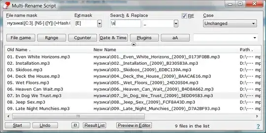

Multi rename script is a open source alternative to Total Commanders Multi Rename tool which you could drive via script. It can use TC plugins for metadata information.
https://code.google.com/p/multi-rename-script/ http://multi-rename-script.googlecode.com/svn/trunk/docs/res/MRS.PNG

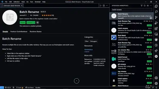

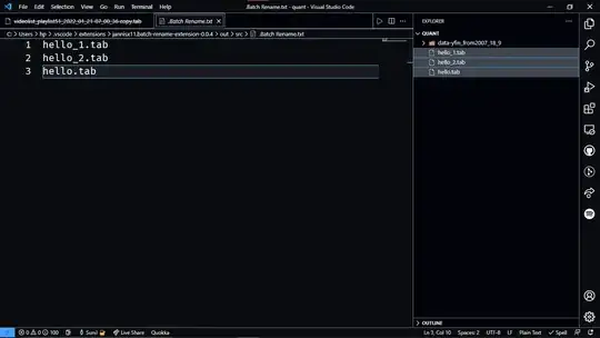

New Answer [2022]
For developers, there is a very easy way to do bulk rename files.
Step-1
enter image description here Install batch rename extension inside vscode
Step-2
enter image description here Open the folder in which your files are
Step-3
enter image description here Select files you wanna rename, select the first file then hold Shift, and select last file all the files between will be selected or press Ctrl+Ain files tab.
Step-3
enter image description here Rename your file.
Under-the-Hood - This creates a temporary txt file of your file names which is self-destructing after you rename the files.
Upvote so that more and more people can get the solution.

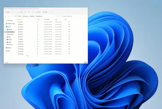

PowerRename by Microsoft
I recommend PowerRename, one of Microsoft’s PowerToys utilities. You can see how robust it would be in that it’s from Microsoft.
The demonstration
PowerRename is a bulk renaming tool that enables you to:
  • modify the file names of a large number of files, without giving all of the files the same name.
  • perform a search and replace on a targeted section of file names.
  • perform a regular expression rename on multiple files.
  • check expected rename results in a preview window before finalizing a bulk rename.
  • undo a rename operation after it is completed.
