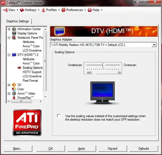

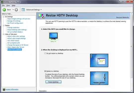

When outputing your video to an external TV, look at the video card's driver control panel, and look for a Scaling configuration page. Adjust the scaling down so the edges of your desktop are matched with the edges of the TV screen.
*whoops i forgot the last time i did this was with another laptop with NVIDIA Geforce that eventually got decommissioned, and was replaced with a laptop with ATI Mobility Radeon.
ATI control panel
For NVIDIA, there should be a HDTV Scaling option when you attach to a TV via HDMI.
NVIDIA control panel

  • This scaling you show in your screenshot is about scaling lower resolutions to the full size of your screen, and cannot help with overscan. You can't usually adjust size and position of the screen for digital connections such as DVI, HDMI and DisplayPort. – Allon Guralnek Jul 26 '10 at 06:47
  • That is what i do to fit my laptop desktop to my TV when connecting with the HDMI cable. Otherwise, i'd have the same problem as threadstarter ablmf. – icelava Jul 26 '10 at 08:03
  • Sorry, the screen cap is not 100% representative of the feature to scale the desktop image "inwards" for a TV monitor. This one is just my office laptop and an illustration. I'd have to go home and perform it on my other laptop. I'll update the picture later. – icelava Jul 26 '10 at 08:08
  • Thanks a lot. I found nVdia video card driver supports making the screen smaller. – faceclean Jul 26 '10 at 17:56
